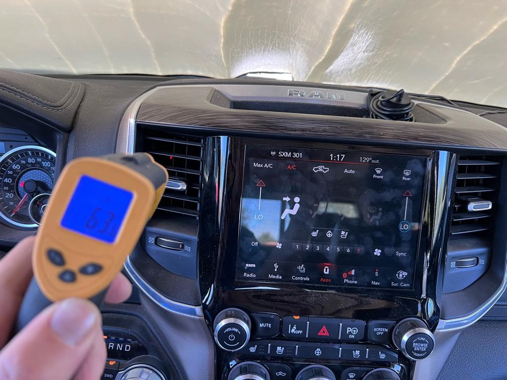

Been sitting in my truck with it running for over an hour trying to cool it down enough so CarPlay will turn on. Outside Temp is 99. Truck thinks it is 129 degrees. Vents are around 60ish. Lowest I could get it to read is 58°. I hate this truck.
Use circulation inside cabin that way you can get lower temperatures. From that pic I see your intake from outside

What is you center left vent temp?
