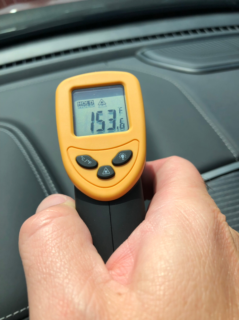

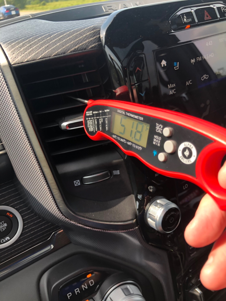

Crap I was wrong, the top of the dash temp was every bit as hot as the hood paint!

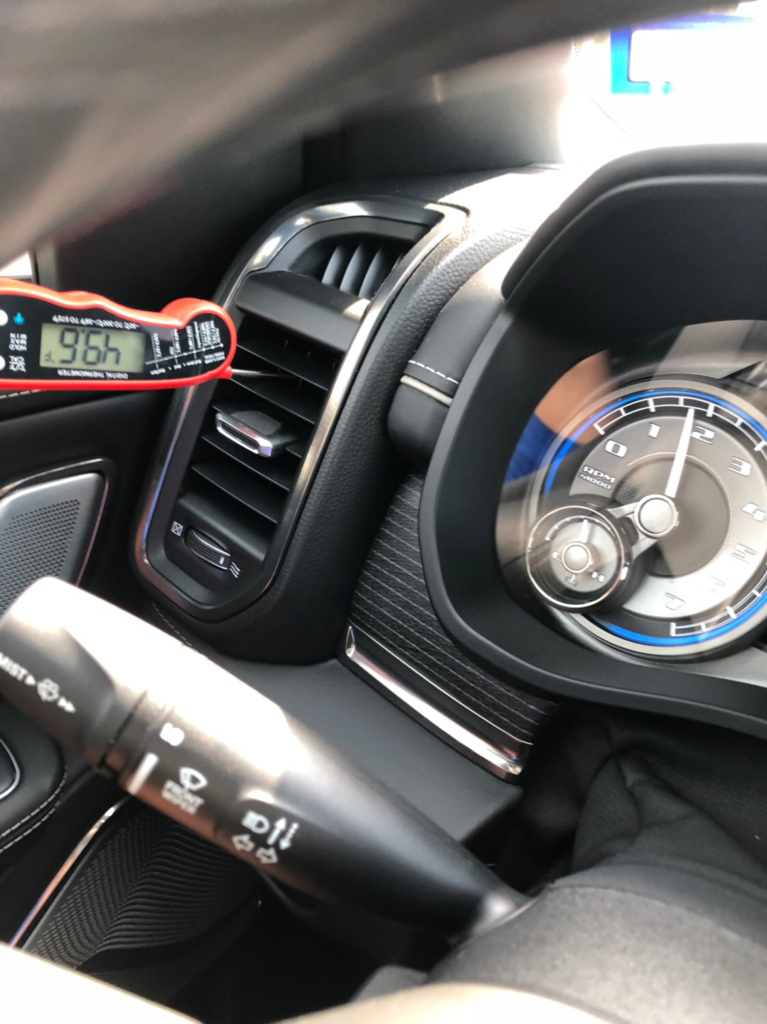

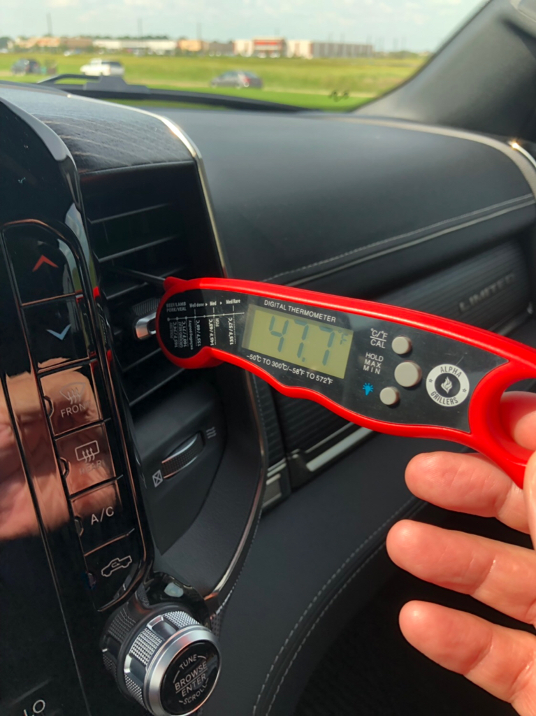

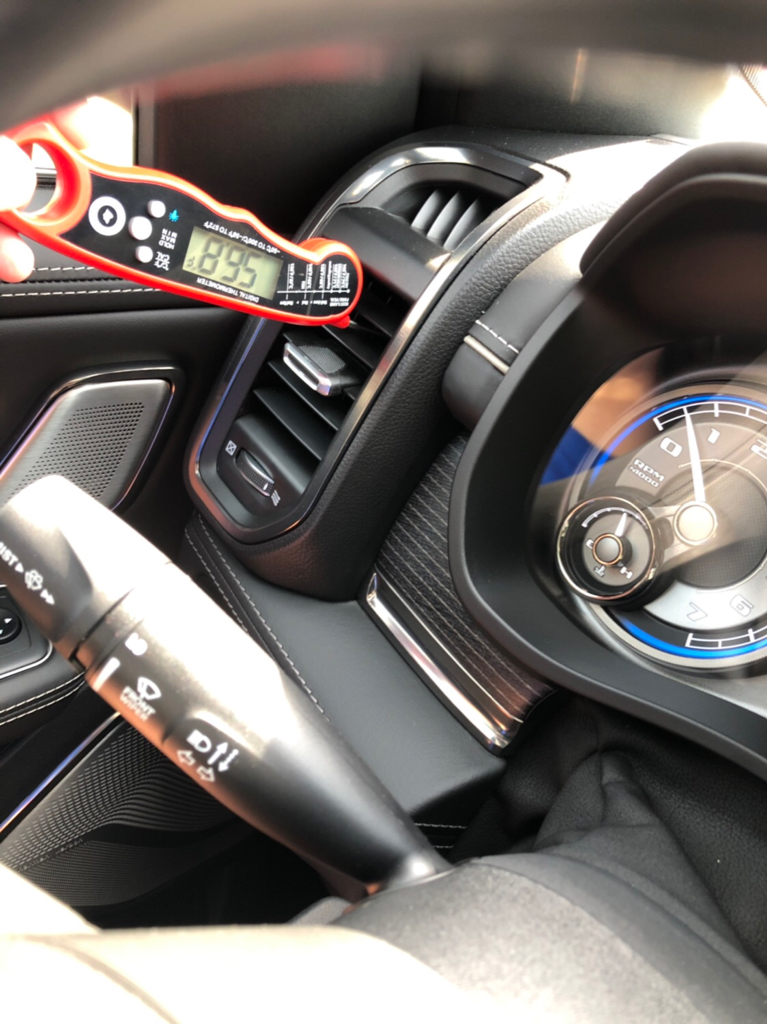

Here are the pics of the vent temps while driving:

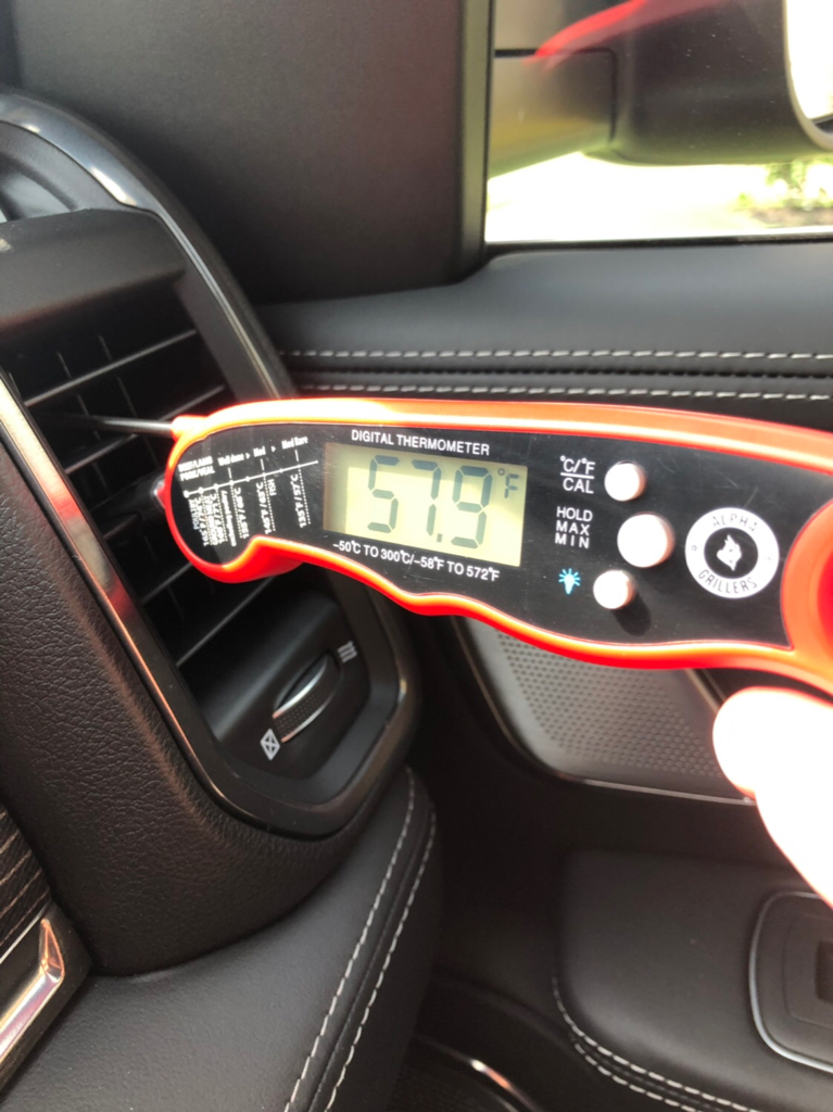

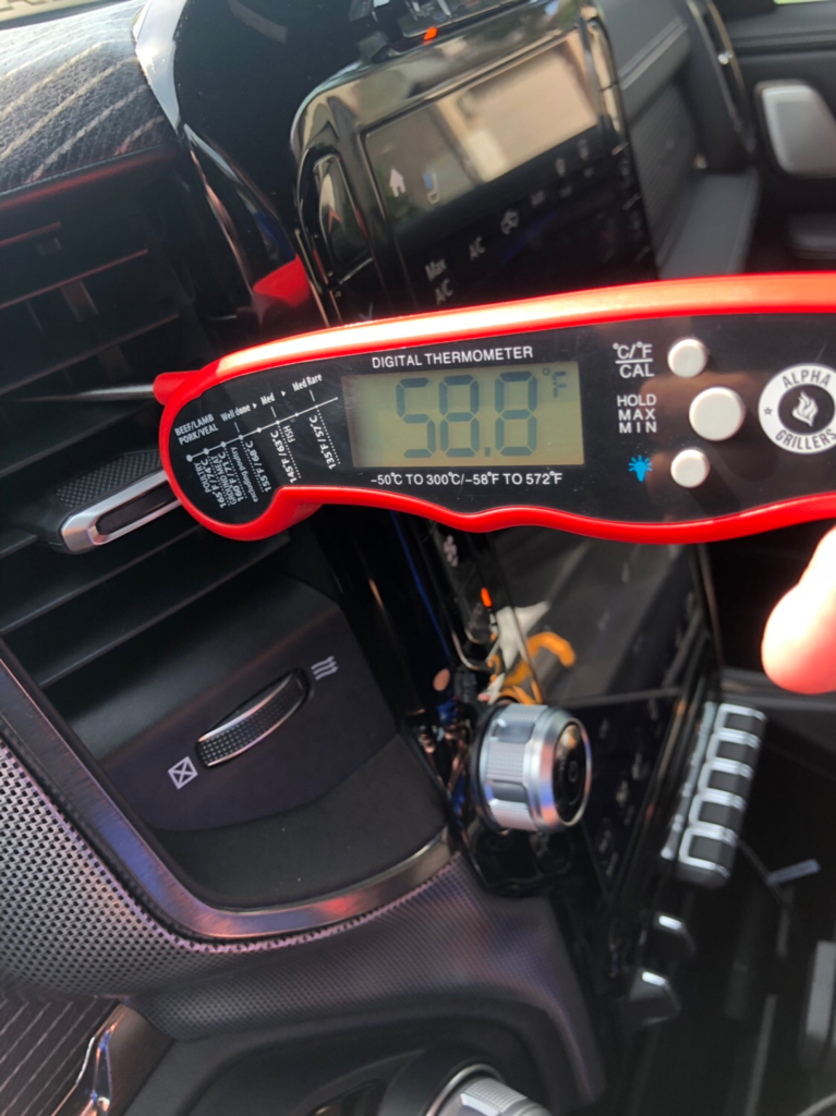

And here are the pics of the vent temps afterward while parked in my driveway:

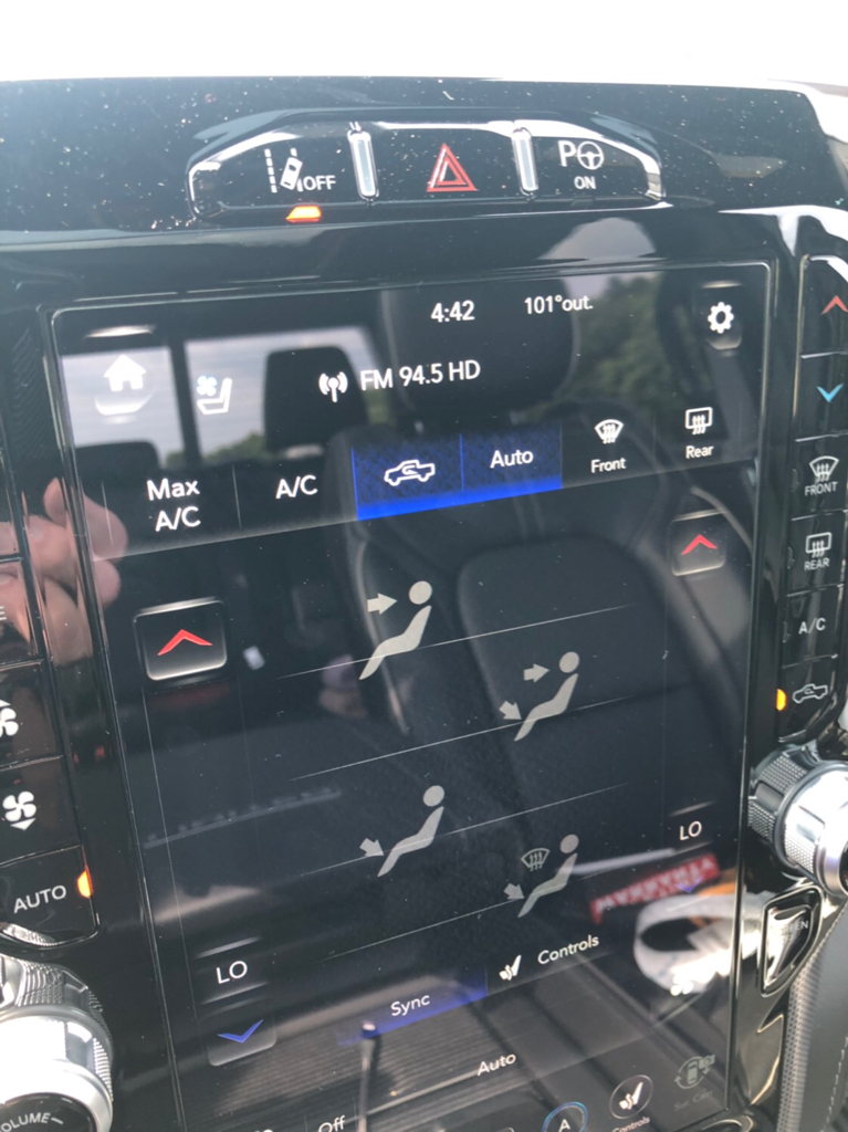

Here’s the settings the climate control was set at the whole time:
Curious, your car thermometer shows outside temp at 101F, where as your digital thermometer shows 153.6F? Probably somewhere in between since you are taking it near the glass in direct sunlight. Anyway looks pretty reasonable to me. I am up the road from you only a few miles. I am comfortable keeping my setting in Auto, Recirc set at 70F.
