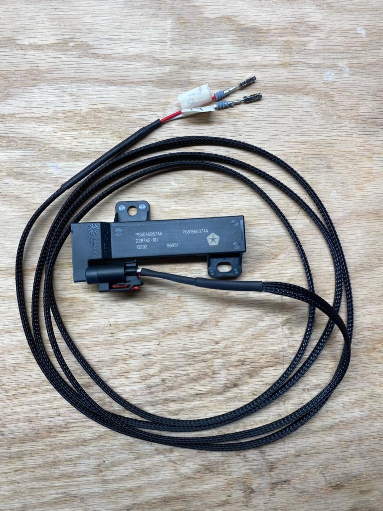

Antenna Part #s -
52112204AA and 52112203AA are for the DT and discussed around page 39 of the adding passive entry thread - 52112204AA is technically for the interior and has mounting tabs 'on the same side' and costs around $12 ($8 online) while 52112203AA is for the exterior and has mounting tabs 'on the opposite sides' and costs around $400 ($270 online)
56046957AA is for the DS interior and has mounting tabs 'on the opposite sides' and costs around $12 ($8 online)
Per post #841 in the adding passive entry thread here - 56046957AA, with mounting tabs on the opposite side (see pic below) will still work with out needing to drill new holes or custom mount
@MayhemMOORE - can you confirm and maybe update your great 'how to' with the specific antenna part number that worked for you (56046957AA, technically for a DS) and confirm the mounting holes, even though on opposite sides, still align to be mounted?
Antenna Part #s -
I’m working on compiling a list of part numbers for everything in all the colors. Handles, caps, and possibly harnesses. It will go up in one of the empty posts.
Check the attachment I added to the first post, it has all the part numbers for building your own harness and the antenna part numbers.
Below is what I installed, and a shot of it in the truck, with temporary clips until I find bolts to mount it properly.
