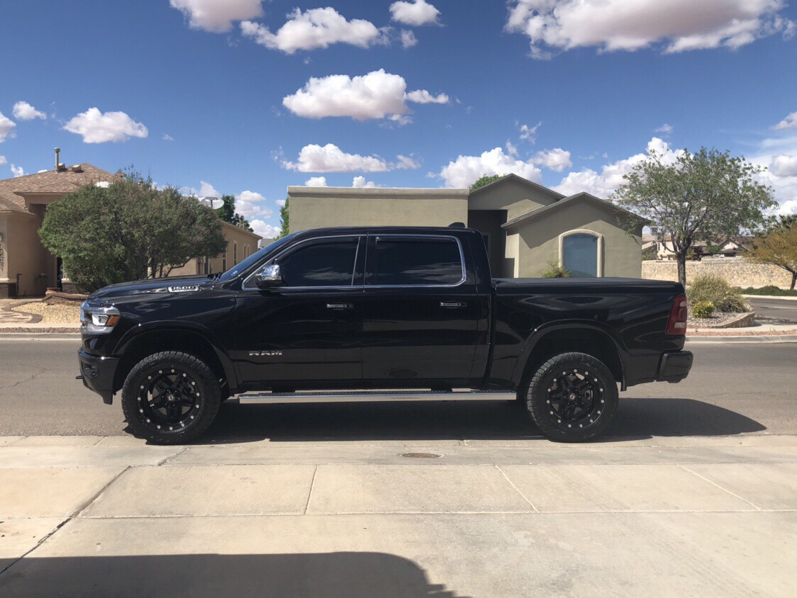

Looks great! Much better than the original kit. I don't ever tow so I prefer the truly leveled look. You did not add the offroad package springs correct? Somebody was doing that and I couldn't remember who. It looks like coupling the updated Mopar kit with the offroad package would leave it almost perfectly leveled with ~1/2" of rake, which is unnoticeable and allows for a little added weight in the bed at times. This would essentially give you the 3.5" that the Readylift kit does but strictly with new struts/springs instead of spacers (except for the rear) giving a much better ride.
That’s exactly what I did. Picture posted above. Mopar 2” Lift with the updates Mopar spacer and ORP springs. As for ride quality, it seems the same as before. I think the tires stiffened it up a bit, bit not to the point where it’s noticeable

...Assuming I measured this correctly, I also did it on the fly so I'm sure its close but may be off slightly:
- Front center hub to fender: 24"
- Rear center hub to fender: 25 1/2"
Honestly it is this perfect amount of rake as it sits almost level with hauling my boat and the right amount of nose down when not towing. I'm partial to a slight rake though.

This is my Laramie Longhorn with 35x12.5 22’s on 1.5 leveling kit. I just ordered the 2inch lift from Mopar hope it improves

You won't be disappointed. Are you adding it to the leveling kit or removing leveling kit then installing MOPAR? I suggest running only the Mopar but it will leave you with a 1-1.5" rake.
(Also, be sure you ordered the Updated Mopar 2" kit that just released in May - which offers the additional 1" spacer in the front - some dealers are still trying to push old inventory and not telling customer's about the updated kit or are unaware themselves - part # 77072424AB rather than the older model 77072424)

If it’s the outdated one, you will need to updated spacer (PN 68465604AA). I will say the spacer is just over 1/2”. Which still left me with 1 1/4” rake. I added ORP springs which is about a 1” longer than the NON-ORP. That gave me a close to level setup.
