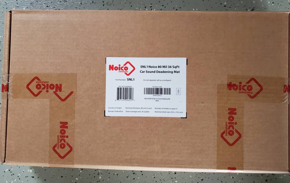

The sound material showed up today and already had the foam for sub wrap. Will start taking the back apart and find a solution for the vents as I don't have kitty litter containers. Maybe some cheap plastic bowels cut out.
This is one heavy box
