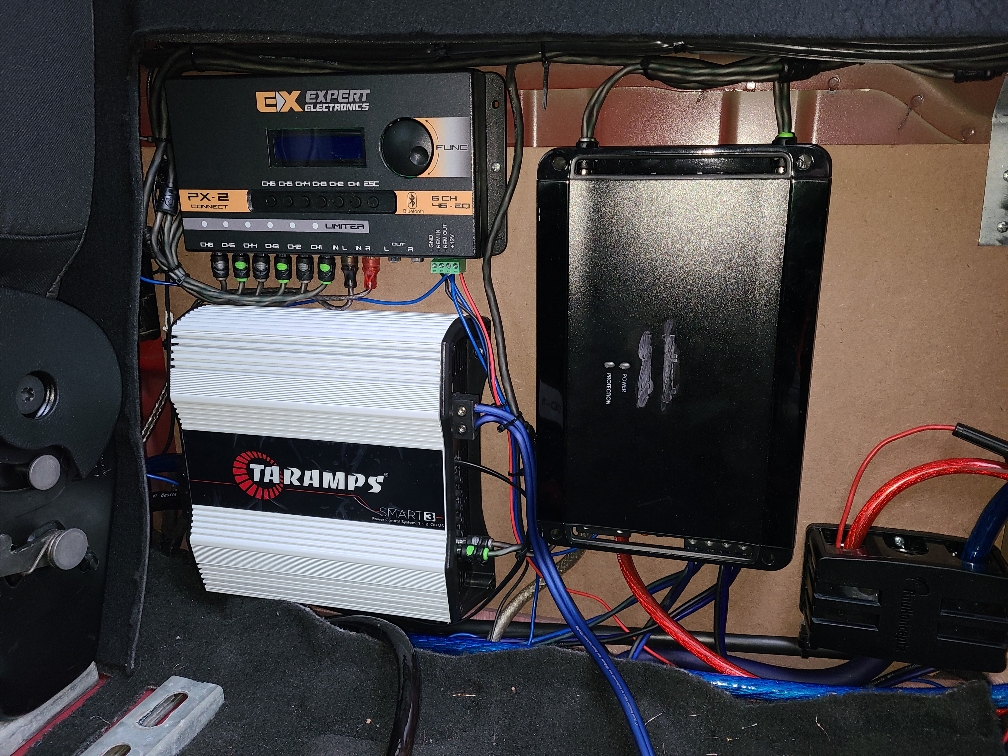

Today i installed the 4 channel amplifier, the new subwoofer amplifier and the DSP i was able to fit all behind the 40 seat wired everything and set the gains and crossovers, tomorrow i'll install the box with the subwoofers, can't wait.

I'm not familiar with the DSR1,I have the PAC module and a Bluetooth 6 channel DSP, I don't feel the need to amplify the back door speakers for now but knowing me I'll end up doing it just not using a 6 channel amp I rather use 2 x 4 channel.

Finished my stereo upgrade, posted pics of the amp set up in case it helps someone. 2 - 75wx2 (RMS) amps for the doors and a 500w (RMS) monoblock for the subs. Tied-in to the wiring at the ANC amp under driver's seat, used the PAC bypass harness.
Speaker set up:
* Dash - 3.5" Infinity Reference (+ 4 ohm resistor)
* Fr door - 6x9 Infinity Kappa (slight mod to the opening to fit, sounds amazing, would definitely recommend to anyone without a sub, big base improvement over stock, also high db sensitivity so it evens out the brightness of the new dash speakers)
* Rear doors - 6x9 JBL Concert Series (wouldn't recommend, I will eventually swap with Infinity Kappa 6x9s)
* Subs - Infinity Kappa 10"
