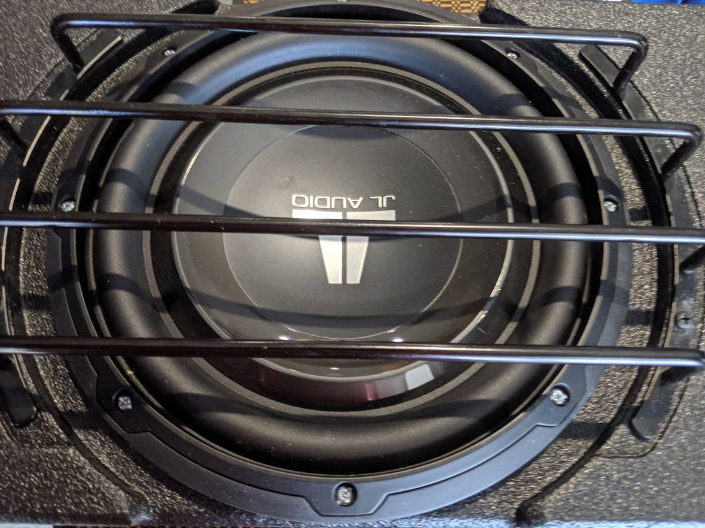

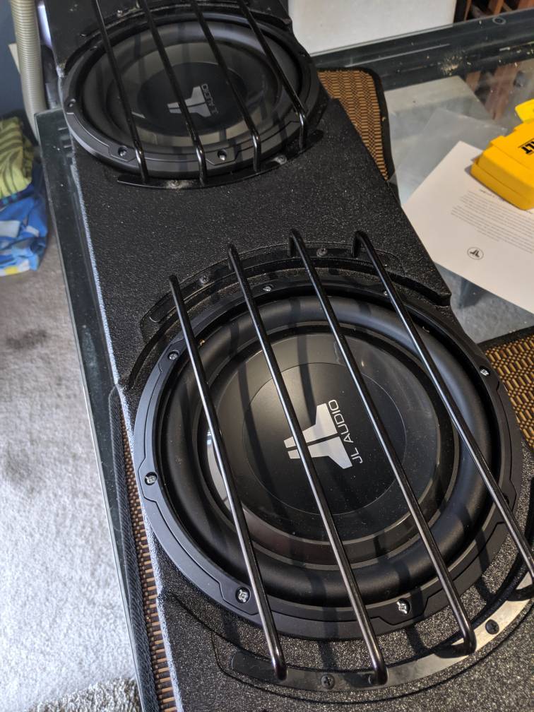

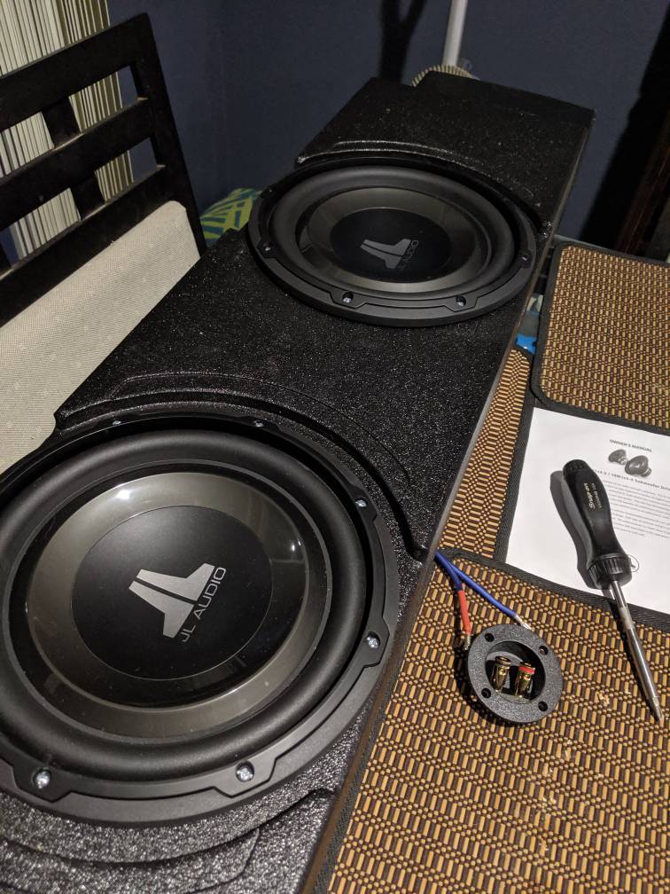

I had a shop in Bellevue, WA build it for me. It’s a custom design and build for my 2019 RAM Bighorn. It was CNC cut and loaded with 2 JL 10TW3’s. Had to disable the ANC but haven’t noticed a road noise or engine noise difference. Playing tunes with this beauty all the time anyways...best ANC solution in my opinion.
