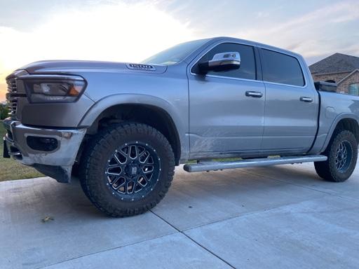

Are you running the RL 3.5 kit? Pics of the truck please?

Yes. RL minus the very top spacers 5100s on max height. I have about 1/2” of rake. Exactly what I was looking for.

Sorry for being picky but could I get a direct side shot? I 've been sitting on my RL kit for a year and have been torn between doing the RL 3.5 w/ 5100's and the BDS 4" Kit. Finally decided on the RL since I already have the parts. Gonna do 5100's and 5160's and RL 3.5 kit w/o preload spacer. Another member on here put the 5100's on #5. Do you have center of hub to fender measurements?
