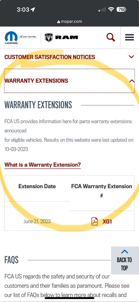

I went to Southfork Dodge Yesterday and they have replaced my rear window same day. There were no cracks, just bad seal at the corner. 2 Years warranty for the job. My 36/3years warranty is over after 500miles.
I'll have to ask about the 2 year warranty as I'll be out of bumper to bumper in about 6 months
They said it is a general rule, 2 years warranty on parts and a labor from the dealer.
What year do you have? I believe it’s only for certain years right now
ok, it states. 2019 - 2021 RAM 1500 Pickup (certain ones by VIN).
Its been stated that they improved the gasket and assembly, so the 22's and 23's appear to already have the newer assembly and aren't included in the warranty extension.
I have a 22 built in July last year it does not have the upgraded gasket. I was installing LEDs in the chsml and looked at it mine does not have the upgrade.
