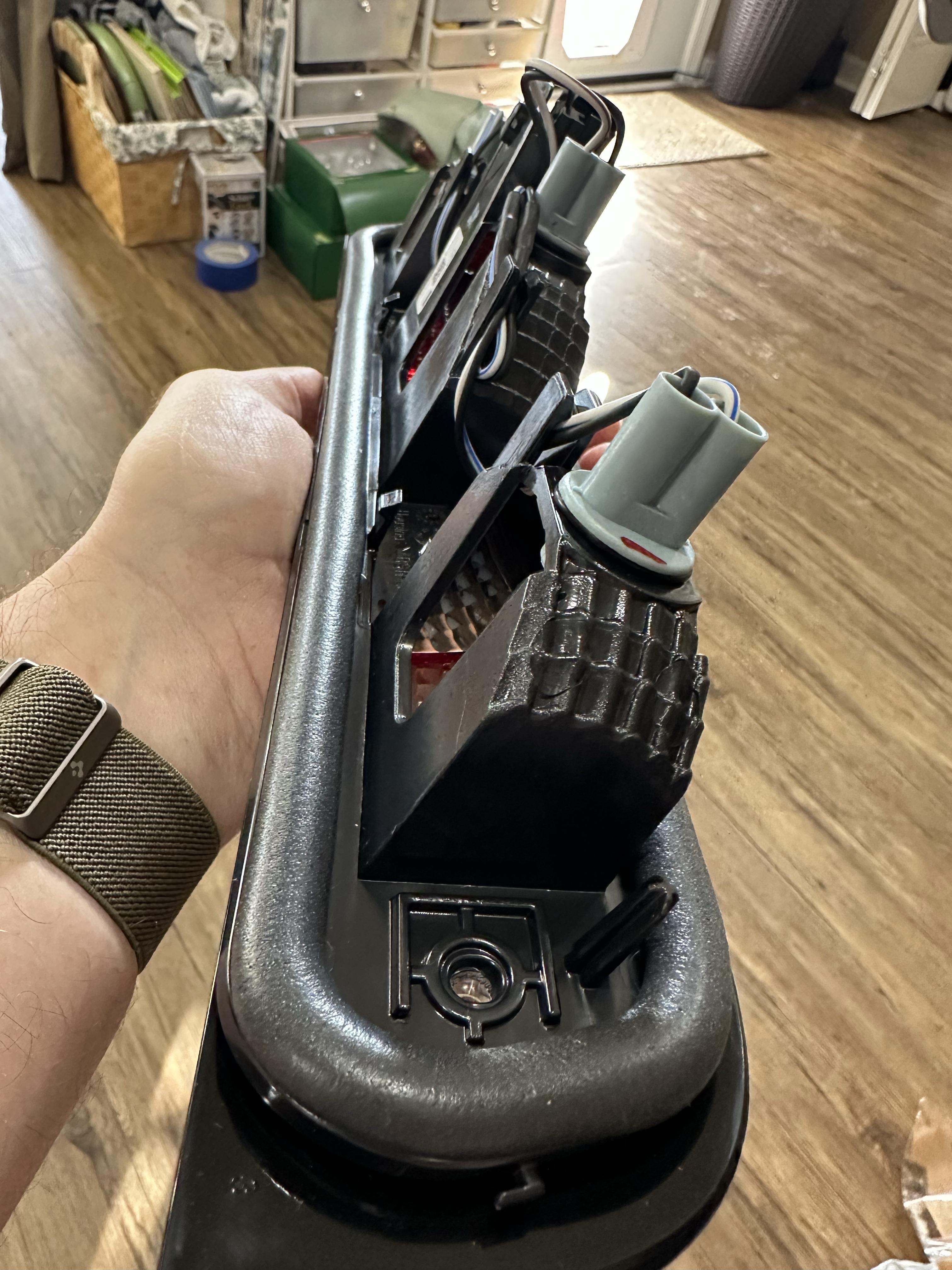

For anyone interested. This is the AH 3rd brake light. Skip g and go h. This gasket isn’t the same foam anymore and it’s substantially taller

This is the one I purchased \/. Do yourself the favor even if you don't have a leak, just get the new one and replace it. It looks like it'll sit way up from the cab roof before you screw it in, but it has a positive seal feeling when screwing it in. going to water test it here shortly.

hmm. i didn't pay 13$ shipping. You're only a few states over from me. not sure why it would be 13$ for you. You can def find that partnumber elsewhere. maybe it's cheaper somewhere else.
BTW: I water tested it for over an hour and no leaks. just leaked 2 days ago from a rain storm with the old one, so I think she's water tight again. Even used a scope to watch behind the headliner. no drips!

That would be my guess, yes. the mounting surface appeared wider also, like they changed the light mold to fit a wider gasket.
Looks like closed cell foam, like marine gasket that has been used as a diy.

Also attached pic is what the 3rd brake light gasket looks like. Looks like the upper gasket is coming loose. Regardless if it's the cause of the current leak I'm going to by the new version since it's cheap.

The new and improved light came in today and the seal definitely looks much better. Unfortunately I still have a small leak after putting the new light in. So off to the dealer I go to see what they say it is but my guess is that I'll be getting new window.
So is this the new gasket used in newer trucks?
Yes. this is what comes on the 2022+. Works on 2019+ though without issue. At first it feels like the light is going to stick up. once you torque it down though, it's flush.
