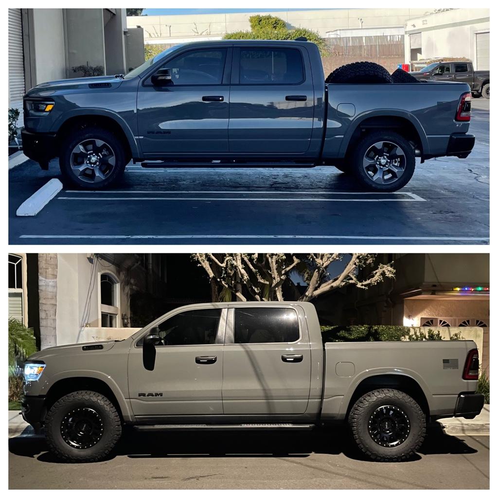

Finally got my Method wheels with 35x12.5 KO2’s
Are these the 18x9 -12? Wanna get but im scared they wont fit or wont clear brakes
Yea they are 18x9 -12 and didn’t hear any issues. I think they are super close but people have not had issues. The item # of mine are MR30589060512N
Just did a quick trip out to Palm Springs from the beach and with the 35’s averaged about 17 MPG with my set up as well for anyone wondering about the MPG
