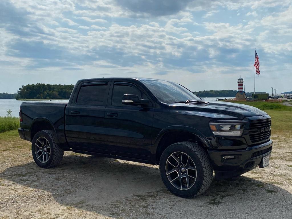

Just added 34s(275/65R20) Falken Wildpeak AT3W’s on my stock offroad package w/o air ride '21 Laramie.
Fello jersey folk...with the same taste as me going to the 34" falken wildpeak.
Debating if I should recalibrate then or not. I can feel the trans shifting a bit differe t going from 18" rim with 32" falken wildpeaks to 20" rims to bring me to 34.1"

I have 3.92's in my truck and I feel like the ratio change to the 34" tire is for the better response-wise to me with the 8-speed. It feels quicker than it did on the stock 32" tires. I always felt like my old 2014 that had 3.92's and 35" tires felt quicker than my new truck on the stock tires and now it feels better like the old truck.
I don't want to say quicker. For me it feels like it's holding gears longer, like in tow/haul mode. I'm still hitting my 7th and 8th gears with no problems.
Especially 2nd and 3rd gears, it holds it alot longer..

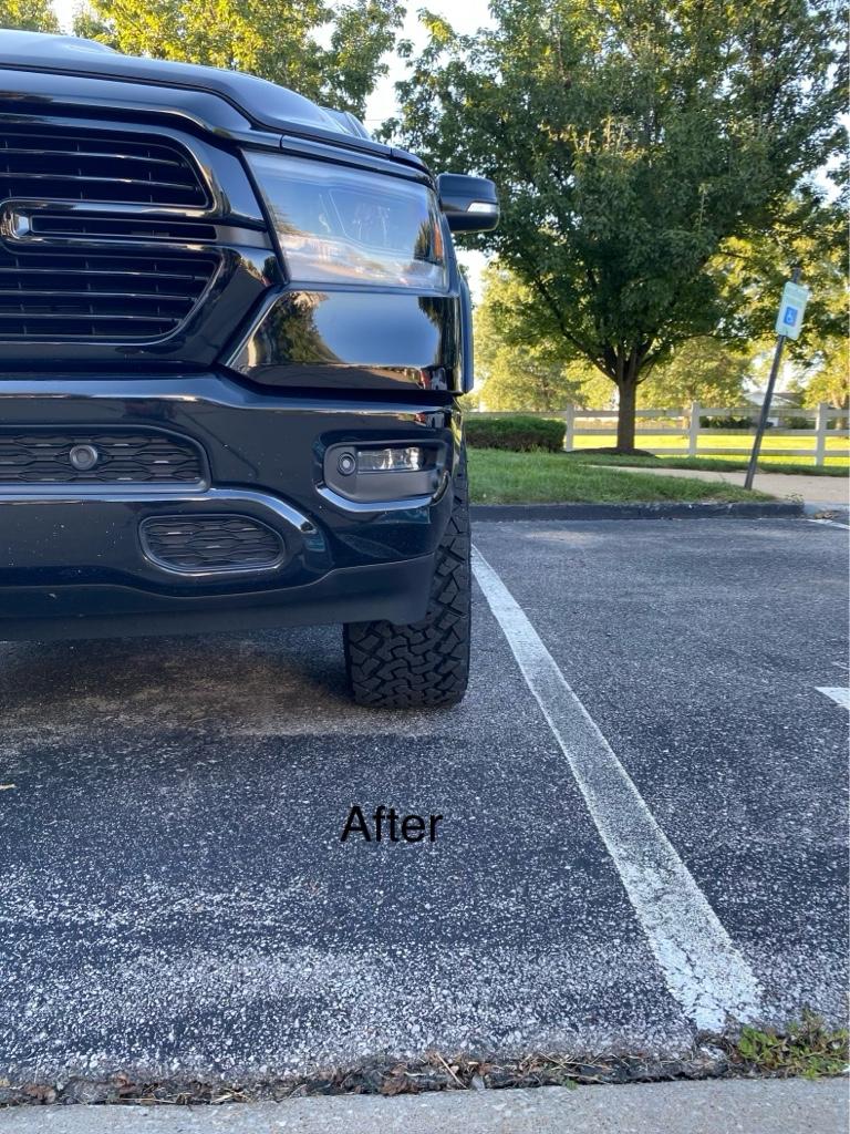

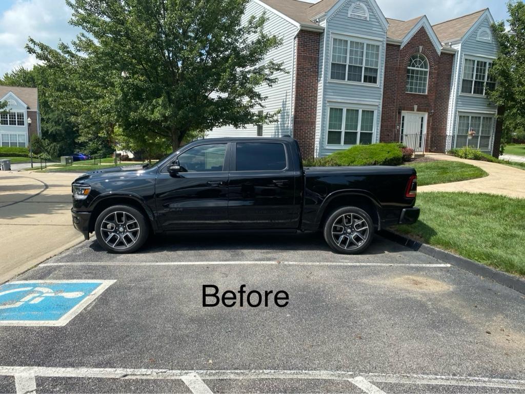

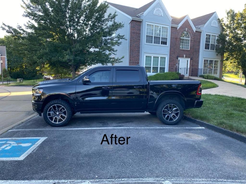

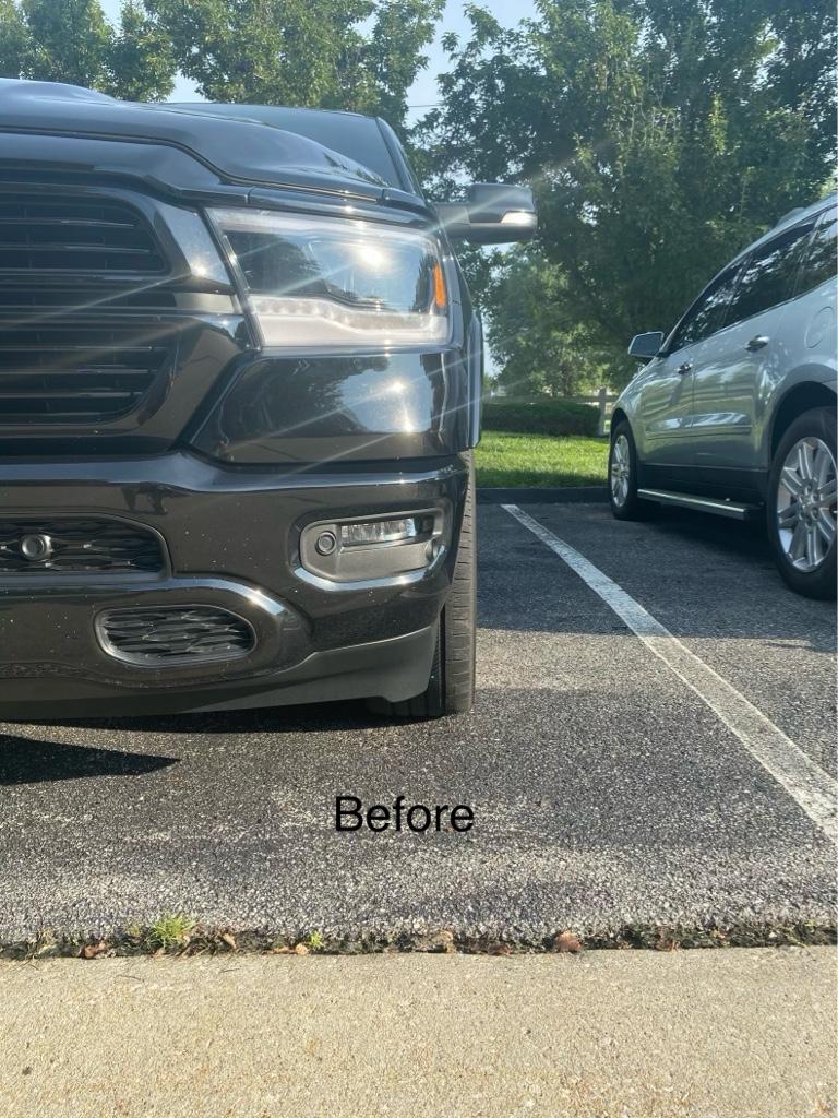

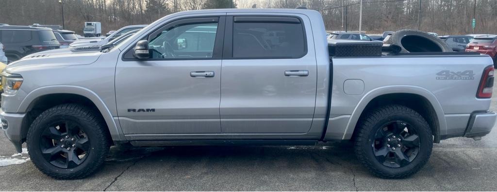

Just had 295/65r20 Yokohama Geolandar MT's put on my stock night edition wheels. Fits without issue. My speedometer is off quite a bit at higher speeds. When seeing 55MPH i'm actually going 60. When showing 70MPH I'm actually going 82.
Also, have 3.21 gears and I can still smoke the tires. Can tell the tires are there but honestly this thing is still pretty quick. Kinda surprised me. Will be getting tire size calibrated at dealership soon to correct speedometer issues.
Is this tire size upgrade without and other mods? Lift/pacers and no rubbing?
Thanks
Thanks
Only 2.5" motofab level. No other mods, no spacers. Stock wheels. I think even a 2" level would be enough, as height isn't the issue with these tire sizes it seems. It's width of the tires and how close they get to the front and back of the wheel well. I clear that just fine in mine.

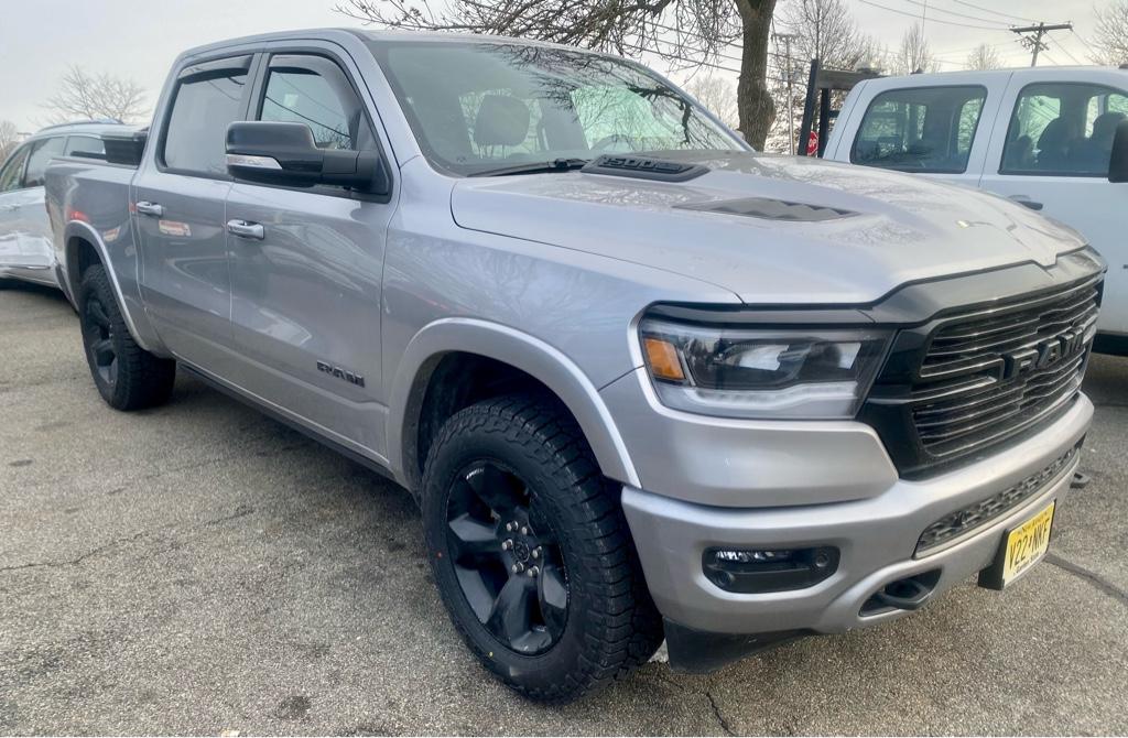

275/65r20 General Grabber ATX. Other info on my signature.
Drop some pictures in here of your 34 or 35 inch tires! Trying to get a feel for what I want to go with. Is there much of a difference in MPG between the two? Im about to put the MOPAR 2in lift on and I'm torn between 34's or 35's. Goal is to see if 35's look stuffed or if 34's make it look too roomy. Thanks for your help! Any input is appreciated!
