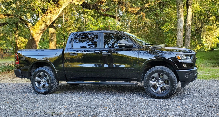

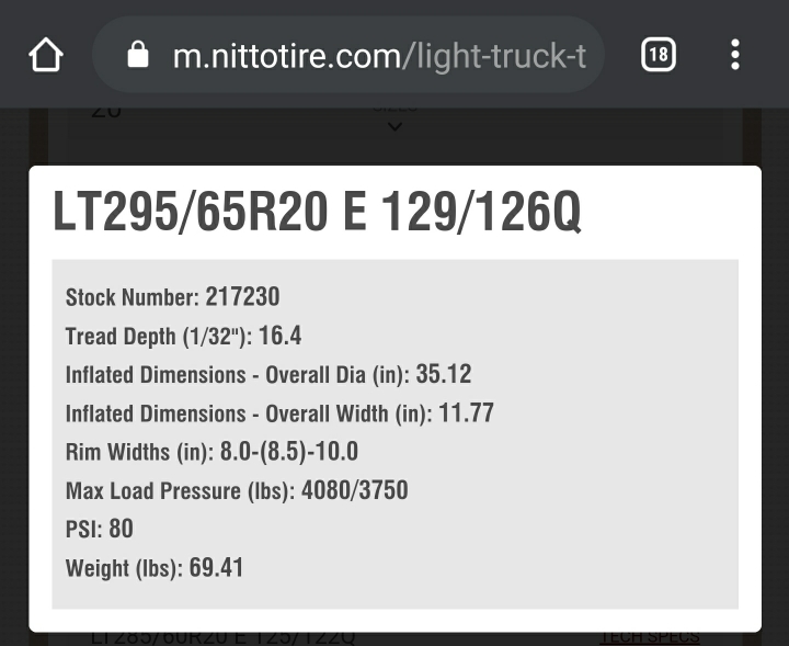

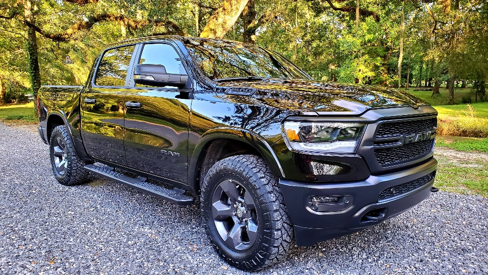

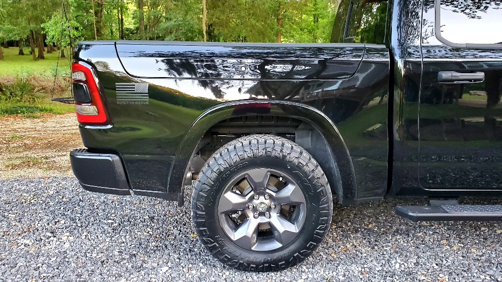

35's (295/65r20) 2" level
Sent from my SM-N976V using Tapatalk
Are you running any spacers? I have 2020 BTS and doing the RC 2” Loaded Level struts up front. Really like the look that you have there!
