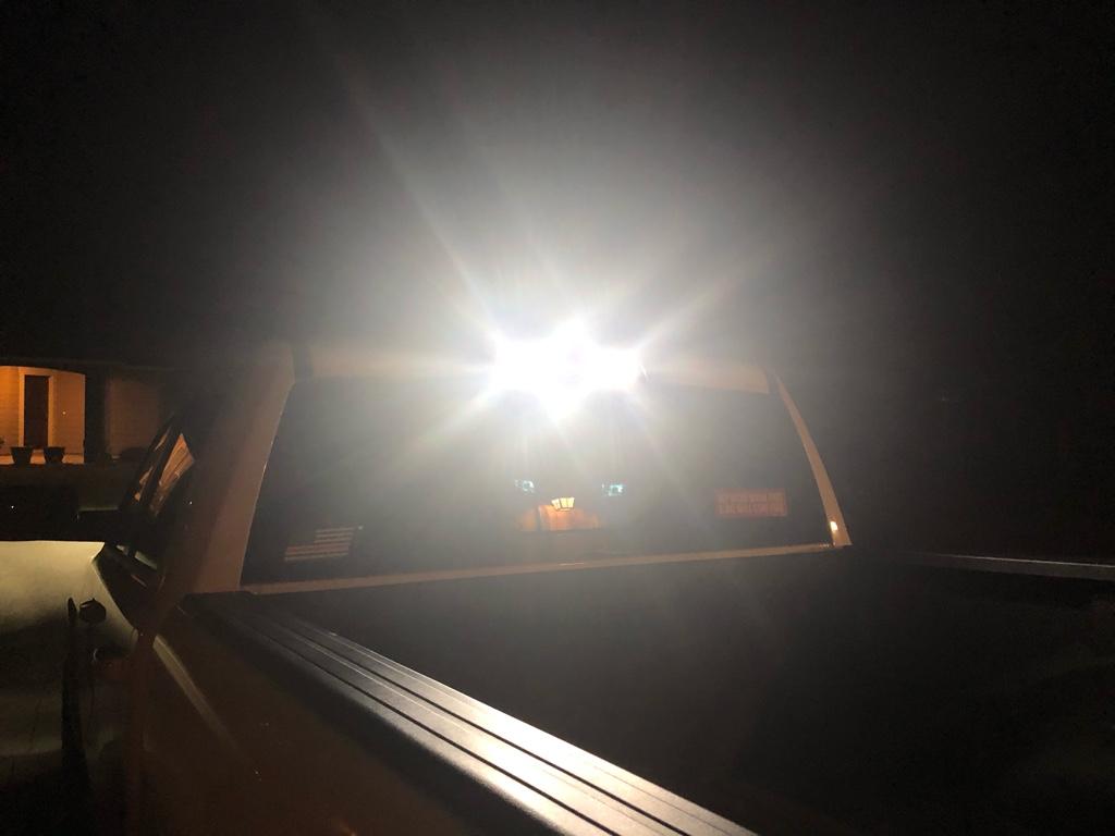

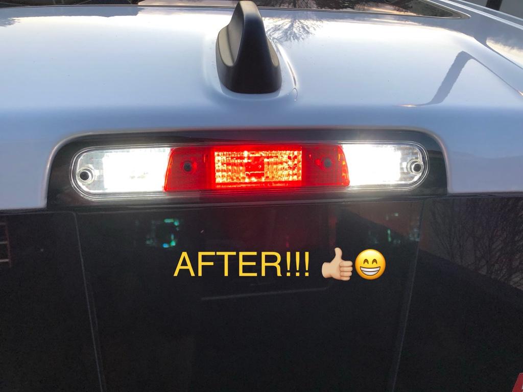

I just installed the Lasfit RT15 (cargo) and RT15R (3rd brake) LED lights. Thus far I have zero complaints and work in perfect synchronization with the fob, brakes, door sensors. Granted I’ve had them installed for 3 days thus far, but zero complaints. Super bright! Full disclosure, I was sent the lights from Lasfit. If you decide to give them a go, code RAM10M gets you 10% off. I also do not profit from the code. Help that helps and good luck!
