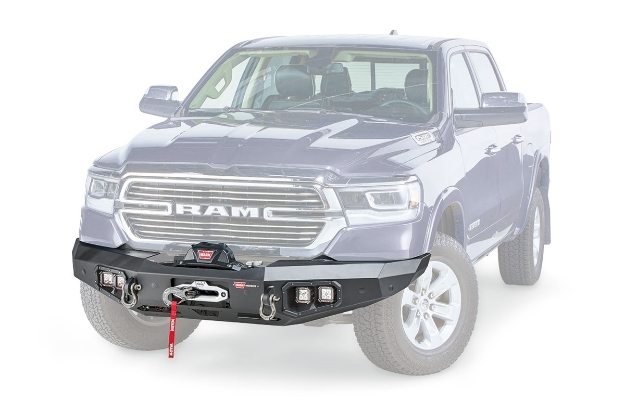

Hey everyone, I was wondering if any of you had luck with the Warn 103638 bumper. Says it’s for all 19+ Ram models. I have a 2020 Ram Rebel… wondering if anyone has tried one out yet? I would really like one on my Rebel. Pics if you do please!!
heres the link for reference:
Thanks in advance!
