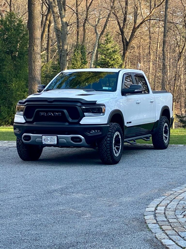

2020 Bighorn 4wd quad-cab. I went with the Eibach pro-truck lift and I believe it was the 2.0 if I’m not mistaken. Coils, rear shocks, adjustable struts and whatnot. I originally wanted something in the neighborhood of 33’s and a hair tougher than stock, but you know how that goes lol.
I’m not a fan of dozing with the brosephs, so the 18” wheel choices are rather limited as you all have become well aware. The space between the caliper and the inside of an 18” wheel is rather nonexistent. And the factory wheel being a positive 19mm leaves nary a fingertip between even the baloney-skin 275’s and the upper ball joint.
I realize there’s probably a whole slew of wheels out there that do fit, but if you’re not into faux bead-locks, or you want a smooth lip, it really does narrow the pool by a lot. We’re kind of limited by offsets as well when it comes to just a simple off-road design. It seems like you either get a +18, a +0, -12, or from there it goes into rock chipping territory.
After a ton of cruising the internet and finally perusing WheelPros website, I finally found a plane-jane wheel in a zero-offset that fit the bill. I decided to wrap them in 285/75/18 BFG KO3 rubber. I wanted a noticeably taller tire than stock, but not cartoonishly wide. As it turns out, I got not noticeably wider, but cartoonishly tall lol. Kidding. Maybe a little. But I’m happy with the results for now and I did not have to trim a darn thing. I may grab the spanner wrench and give the front struts another turn or two after the suspension settles. But here she is. And thanks again for allowing me to fly under the radar and creep the forum lol.

Got a little mud on her yesterday. If you zoom in it’s a lot better than it initially looks. Sucked cleaning her all off to get back to mall crawler status but it was fun while off roading. Tire and suspension details in signature IMG_7383.jpeg
Got a little mud on her yesterday. If you zoom in it’s a lot better than it initially looks. Sucked cleaning her all off to get back to mall crawler status but it was fun while off roading. Tire and suspension details in signature View attachment 190508
I'm not seeing Wheel/Tire/Susp specs in your signature..Looks like Fuel Rebel 20x9 1mm, but what tire/size are you running..it looks good with your level! 👍
