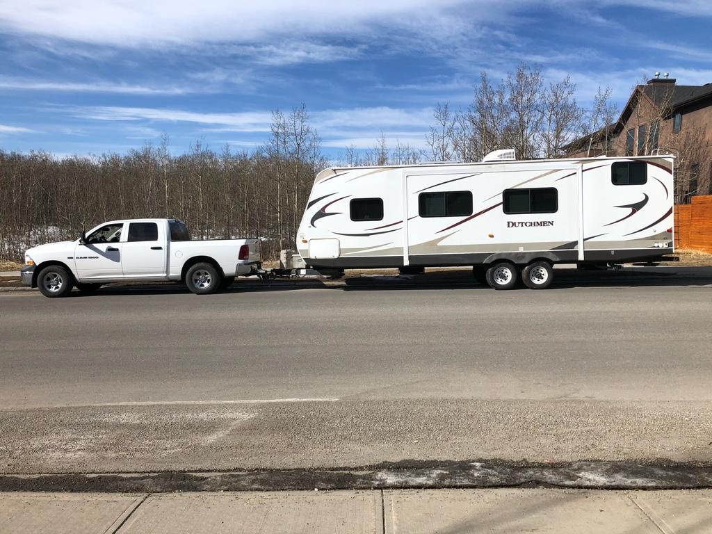

Here’s what I towed behind my 4th gen ST, basically a tradesmen, no options with a 1360lb payload and 6900lb GVWR and I was maxed with nothing in the bed. 2 adults, 2 kids well under 100lbs and a 7600lb trailer, highest scale weight for a two week trip, was down to almost 7400lbs for shorter trips (less booze). This will be behind my 2 week old Rebel EcoDiesel with 1440lb payload and 7200gvwr in a couple more weeks, after break-in period, for the new trucks maiden voyage.
I would say for most travel trailers and these trucks you’ll max your GVWR at about 8500lbs trailers for payloads in the 1600lb range and could be as low as 5000lb trailers for the limiteds and longhorns that are high 900lb to low 1000lb payloads fully option.

How big is your Dutchmen?

33’ ball to back bumper. 27.5’ box. The max is without air bags, all they do is reduce squat, they don’t increase abilities.
