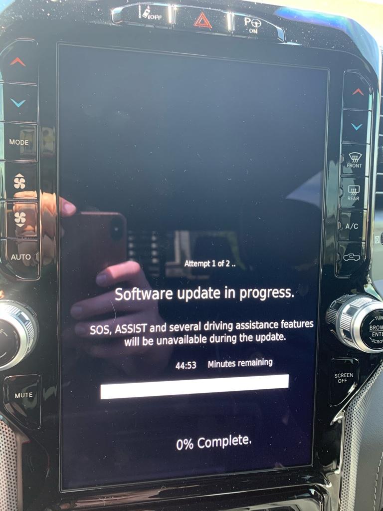

Mine just prompted for an OTA update tonight when I shut the truck off after running errands. it's updating now, said 44 min to update
My 2019 limited updated last night. Photos of old and new software below. Went from software 18.45.40 to 19.49.13
I'll let you know if it fixes the bugs.
There is hope in this world, afterall. :)
Got mine as well......
To my surprise, this afternoon I received notification that an update was available. Of course, I IMMEDIATELY accepted and 30 minutes later was all done. I have a 2019 RAM 1500 Limited - June 2019 build
