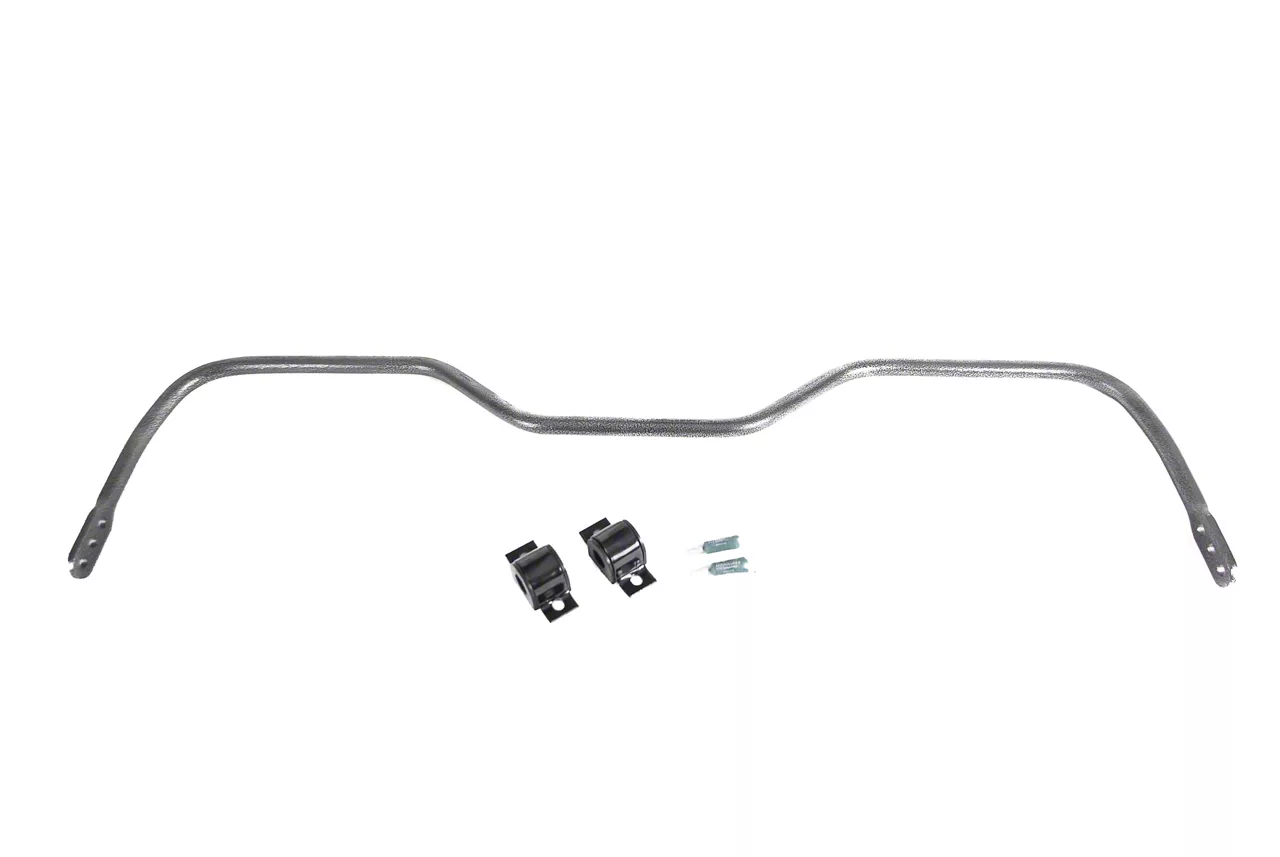

Which has more torsional rigidity: A 7709 at it's maximum setting or a 7793 at it's softest setting?
Below is the reply from Hellwig:
"The 7709 on the 3 hole is 116 lbs/in
And on the 7793 on th 1st hole is 123 lbs/in"

I think I'll go with the 7709
BTW-the sub $200 bars on Amazon never mention the Hellwig brand name even once. I will be purchasing from them directly.
