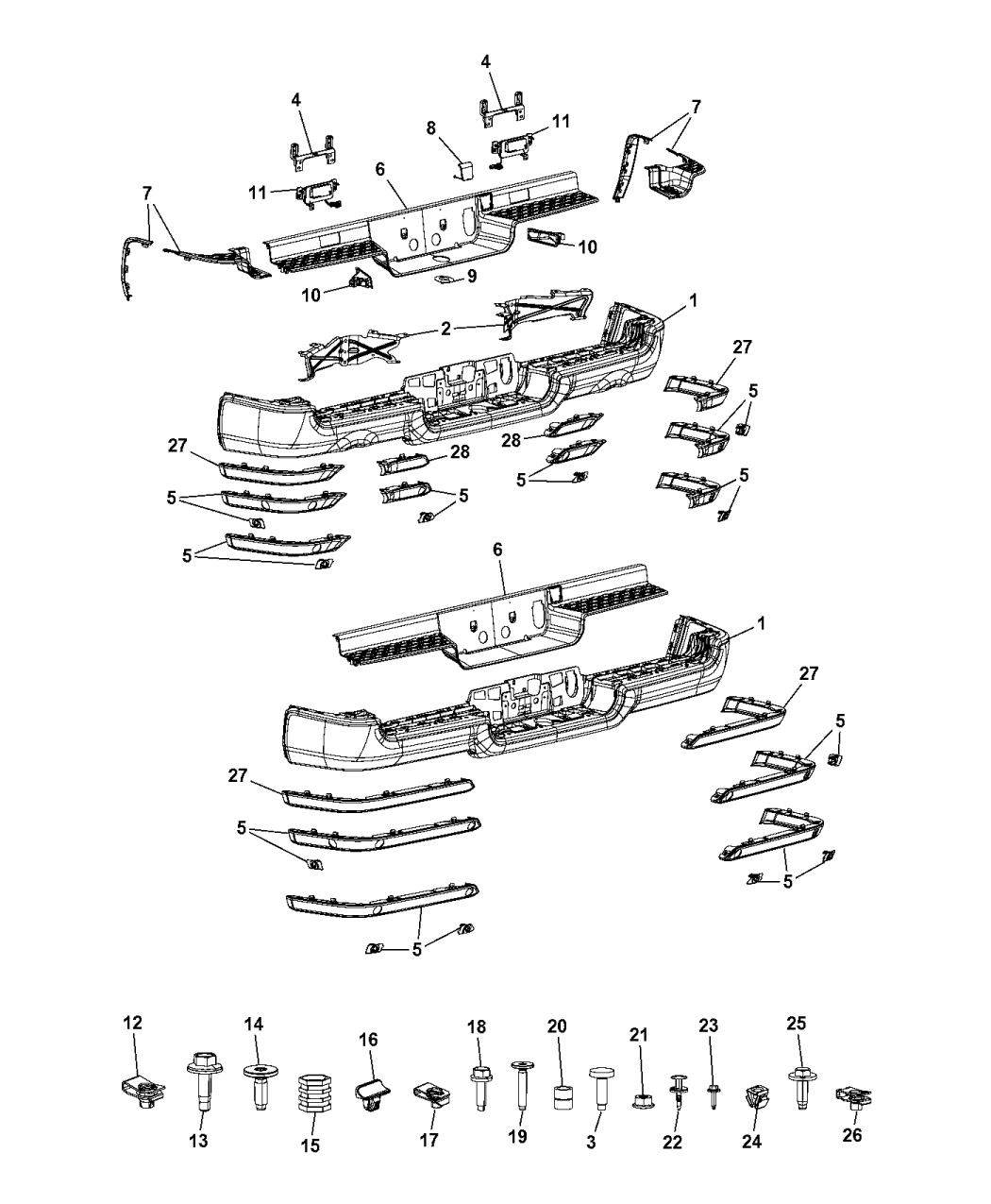

So I just ordered a Limited last week, and one of the mods I'm interested in is rear fog lamps. For those who don't know what rear fog lamps are, the Wikipedia page on automotive lighting has a good summary. In short, they shine at the same brightness as brake lamps, and are intended for use in low-visibility conditions to make your vehicle easier to see from the rear. I do a lot of highway driving for work, and I believe rear fog lamps improve safety during severe rain storms and heavy fog conditions.
I've done a bit of research, and it seems the engineers designed rear fogs into this vehicle (confirmed). I believe the symbol is included in the instrument cluster, and I've seen references to a "Rear Fog" setting in both AlfaOBD and TazerDT settings lists. I was able to find part numbers for the items required to do this mod, with the exception of the fog lamps themselves. These parts are listed in the following table. Since I do not have my truck yet, I have the following questions if anyone is able to help:
  1. Does the rear wiring harness included on the Limited (or any other trim) have the connectors for the factory fog lamps?
  2. Does anyone have information on the part number for the rear fog lamps, or if they will ever be manufactured?
    Answer: rnoggle provided the answer below this post. The table has been updated.
So is anyone else interested in this mod? I'm curious to hear other's thoughts regarding rear fogs. I wrote this post partially to help me keep track of the part numbers, and I will try to keep it updated when new info comes in.
ItemDiagram No.Part numberLink
Fog Lamp Bracket468342213ABMopar Parts Giant
Rear Bumper Step Pad (w/ cutouts for lamps)668342209ADMopar Parts Inc
Fog Lamp1168338769ADMopar Parts Giant
Headlamp Switch (w/ rear fog symbol)168156064ACFactory Chrysler Parts
Rear Fascia Wiring Harness2MultipleMopar Parts Giant
I believe those are only included on the export model Ram. They are Red in color.
I think this is the part number 68338769AD
if you do a google image search on that number, it will bring up a couple images both in foriegn languages.
See here.
Export Ram
Also, there are a couple listings on ebay for that part number, but neither show actual pictures.
See here.
Export Ram
Thanks! This is very helpful - I've updated my table. I didn't realize that the module was mostly reflector, with two LEDs per lamp for the fog function. These actually stand out a bit more than I had imagined - I'll probably apply a smoke film to the lamp modules when I go through this mod.

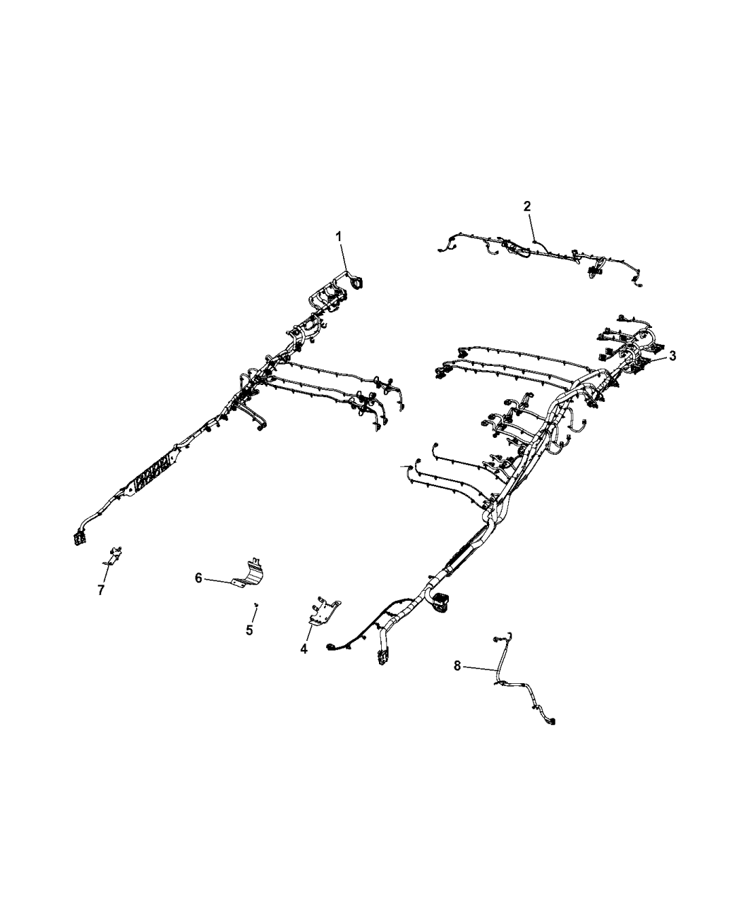

Here is a page to find your rear wire harness.
The trick to this site is to look at all [ ... ] entries and chose the harness that matches what you have, with [Rear Fog Lamps]
For example 68294467AD has the text Rear Fog Lamps, but only Bumper Module I is enclosed by [ ]
Same with 68294468AD it also has the text, but not in [ ] .. that one only has Bumper Module I, Parksense Ft/Rr Park Assist w/Stop, Remote Proximity Keyless Entry.
Now all the following have [Rear Fog Lamps] in their description, with the first number, being the cheapest(in case you want to cannibalize it).
68360457AD, 68360456AD, 68360451AD, 68360455AD, 68358060AD

Aside from the rear facia harness, you’ll need to make sure the rear fog lamp wiring is present in the left chassis harness and the body harness on it’s way to the BCM, where the circuits originate.

Have you determined yet, if the wire from BCM to rear is present? If you are lucky, it is. I would be very surprised if Mopar did not include that one wire for all vehicles.
Two wires, but, I highly doubt they’re there. Quickest way to find out is to unplug this connector underneath the driver seat floorboard, and see if there are terminals on both halves of the connector in positions 1 & 2. Even if they’re not there, they would be very easy to add to those connectors from the BCM to the rear facia connector.
Is the connector in your picture for the "Left Chassis Wiring" harness (no. 3 in this diagram)? If so, it doesn't look like there are different part numbers for with or without rear fog lamps. I ordered a Limited about two weeks ago now, so here's hoping that the conductors are present when I take delivery and have a look.
