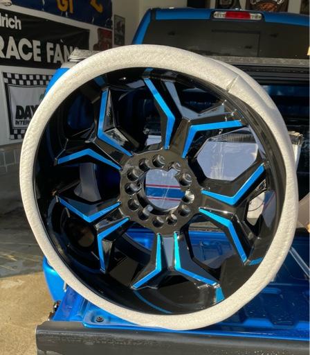

Me too …. Forgot, also waiting on Nitto TG’s …. Rims are back from paint, but they sure as hell aren’t goin on till the salt is gone …. Gotta luv Ohio
