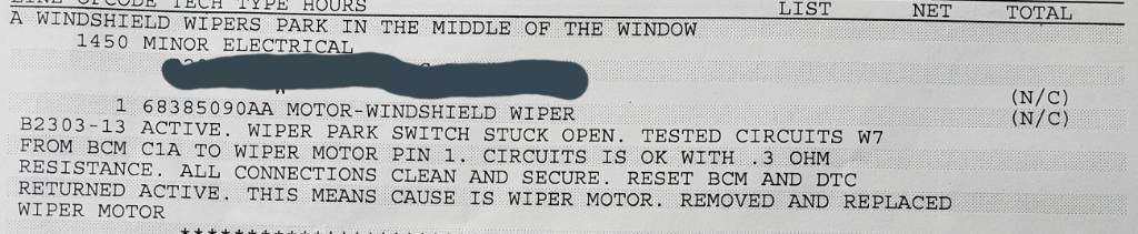

This was my fix. All good so far, but I've only had it back for one night. It did take like 3 weeks for the part to come in.
I got my truck back Saturday. The dealership replaced the wiper motor. It only took a few days and everything is as-good-as new. And they gave me a loaner while they had my truck. FCA and Southfork Dodge handled the situation very well in my opinion.

Brought my truck in yesterday. Had an error code stating signal wasn't getting sent properly. They cleared the code and wipers are working. Ordering part to replace under warranty. I assume it is the lever/switch mechanism.
