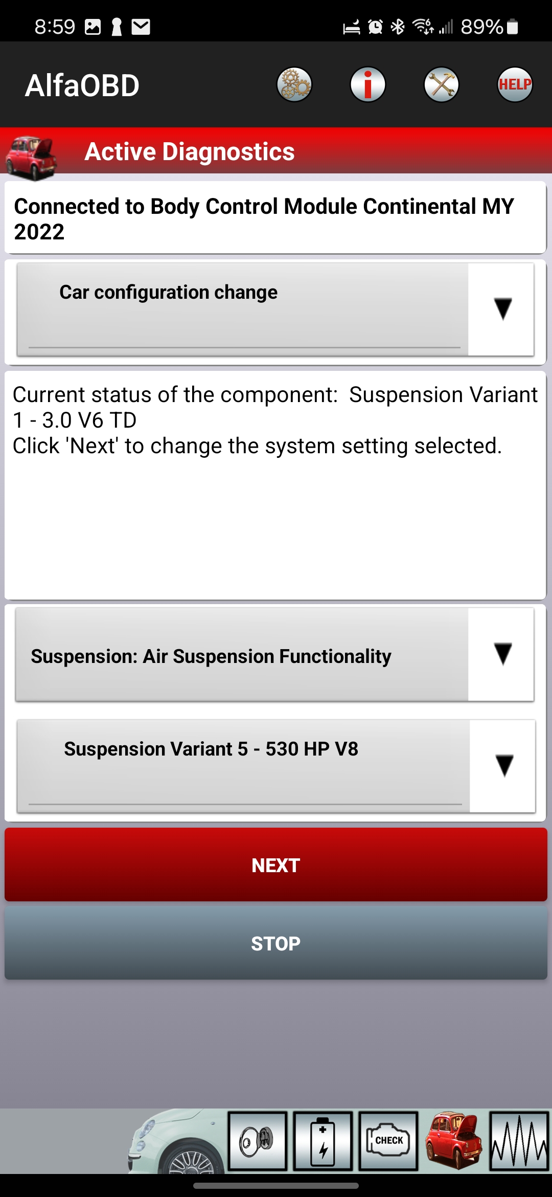

Dakota shocks were replaced about 15,000 miles ago with kyb gas adjusts and it does ride on the high end of comfortable. This 22 ram with air just doesn't seem right. Saying rocking side to side harshly might have been too stern... I mean traveling down a ride at 45mph and slight dips on one side of the road and back up rocks the truck. I just don't think it should do that. I'll crawl under it tomorrow and give it a good look over. To me it feels like the sway bar is broken or isn't attached idk. Any other ideas on what to look for?

Everything looks Kosher suspension wise. I did notice the suspension is set to variant 1 - 3.0L V6 TD. Thought about changing to the closet variant 5 - 530HP V8 but holding off until I get some more information
