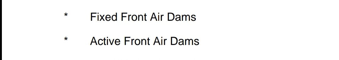

Laramie with off road package:
Sent from my BLA-A09 using Tapatalk

TwinSac
Nov 10, 2018
44
15
Active Front Air Dams...is that the same as Active Air Shutters?

My Limited (with air suspension) has active grill shutters, fixed front air dam and active front air dam...
We’ve already established that yours is evidence of a change in production (either that or just jacked up!) :)
