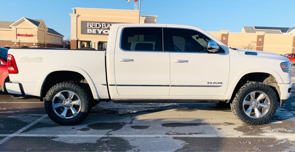

I just got mine back from the dealership after having wheels/tires installed. I’m running a 2019 Limited; Air Suspension; Off-Road Group/Package (adds extra 1” lift); long bed, and had Fuel Vapors (20x9 +20 offset) with Nitto Ridge Grapplers 35x11.50. Zero rubbing at full lock, zero cutting. After searching this site, reviewing multiple threads, I’m confident that this is the largest tire (20”wheel) you’ll fit on a limited with air suspension. Had I not added the off-road package, they would have rubbed. Less than 1/2” clearance at full lock. View attachment 25401
