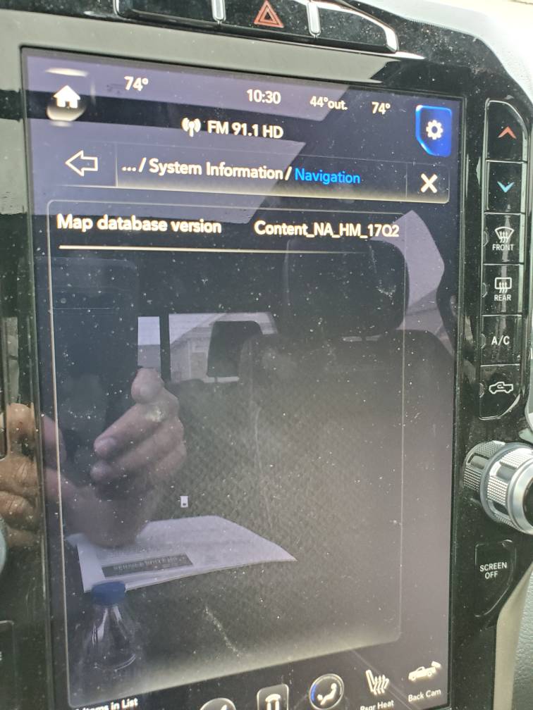

Here is my screen info:
And Map Version

WHAT IS KNOWN ABOUT MAP UPDATES: Absolutely nothing.
Everybody has file "Content_NA_HM_1702", which seems to mean "North America / HERE Map / version 2017 February". If that is the map version that everybody has the data is likely from 2016.
In the post above, HERE Technologies mentions version "10" from October 2018, but there is no way to relate their version nomenclature to Ram's. But then HERE says they have no idea which version Ram actually is using even though Ram is their customer.

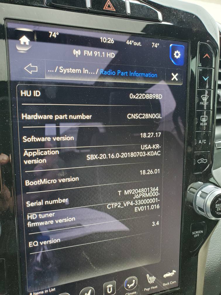

The truck was apparently built in October of 2018.....real brand new apparently. ;) I got a great deal so I'm not complaining.20190620_200112.jpg
Here is my system info:
Am I just being critical or is there something to this? My build date just falls outside of TSB 08-123-18 (Jan-Aug 2018). I mean it's not like I started searching for things to whine about with my new truck; its noticeable enough that I was specifically looking for poor audio performance.
I have an appointment for next week with my dealer; I'd like to know if I'm wasting everyone's time or if I should expect an update.
Thanks!
The TSB turns the bass way up, so It sounds like your build is "proper". I like the update over the low volume of the previous build, but there was definitely a little quality and refinement lost when the update was performed. I agree with most around here, that there should be more than just a three band equalizer, especially with a dedicated sub.
