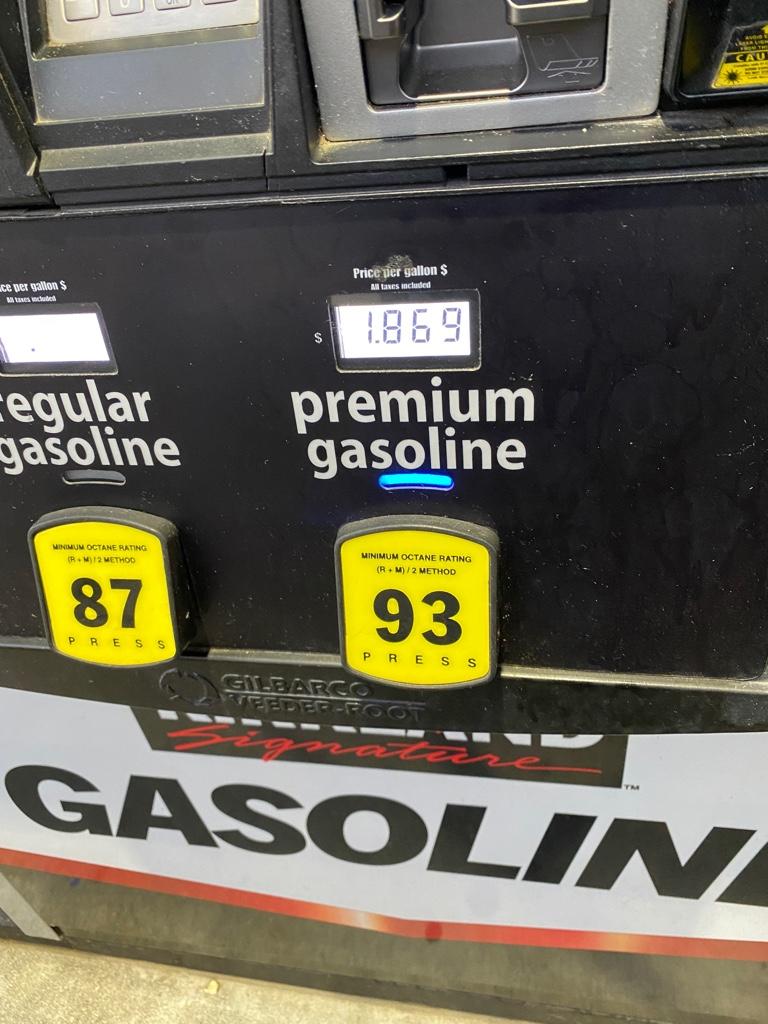

It is in my area, so lets call it a local thing, but I think this applies to most of the country. Typically, Costco premium is cheaper than name brand 87.
So you don't actually have proof that our Hemi get worst mpg with 93? You are making an assumption here unless you have some sort of link that shows it to be the case.

Costco premium $1.99 Atlanta
Price is down on premium Atalanta
89 octane here is 2.25 at irving, sams 93 octane is 2.03. My girl gets sams high test unless im nearer to an irving.
