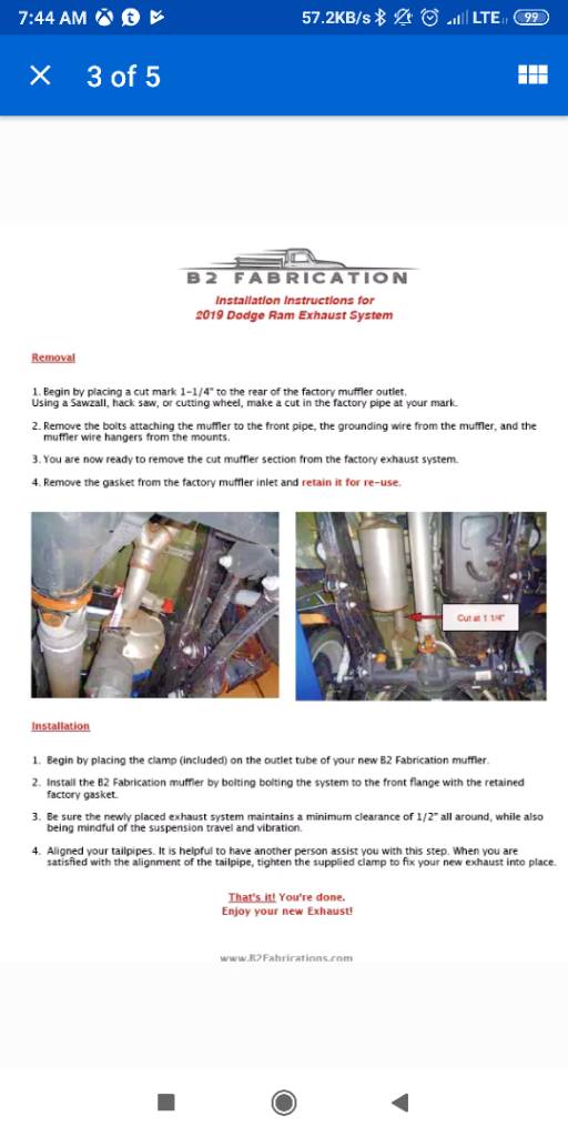

I'm sorry, I'm a little confused. You use the word 'cut' (implying you literally needed to cut the pipes), but then say it's a bolt-on... I assume you didn't literally cut the pipe, but rather just un-bolted the resonators?

Cut off, and then bolt on, they are not mutually exclusive.

You have to cut the pipe directly behind the stock muffler. Then you unbolt the pipe in front of the stock muffler. When you go to install the new muffler you put a clamp on where had cut it behind the muffler. the front bolts right up to factory. If you look at the picture you will see the original stock muffler has a bolt flange on one end and is cut on the other.

Here is the instruction sheet that came with it. I probably should have just posted this first before my long rambling response.
Sent from my MI MAX 3 using Tapatalk
