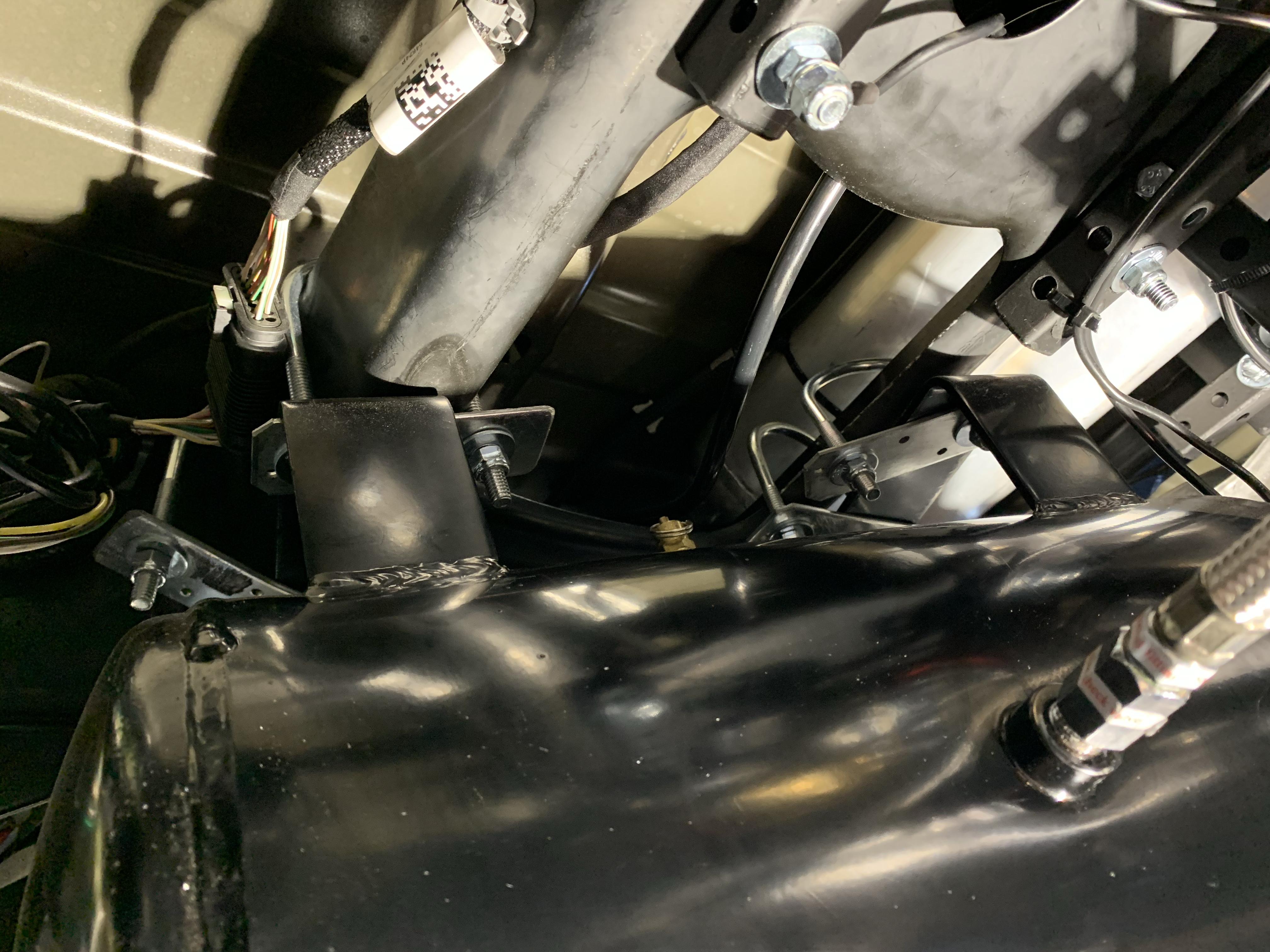

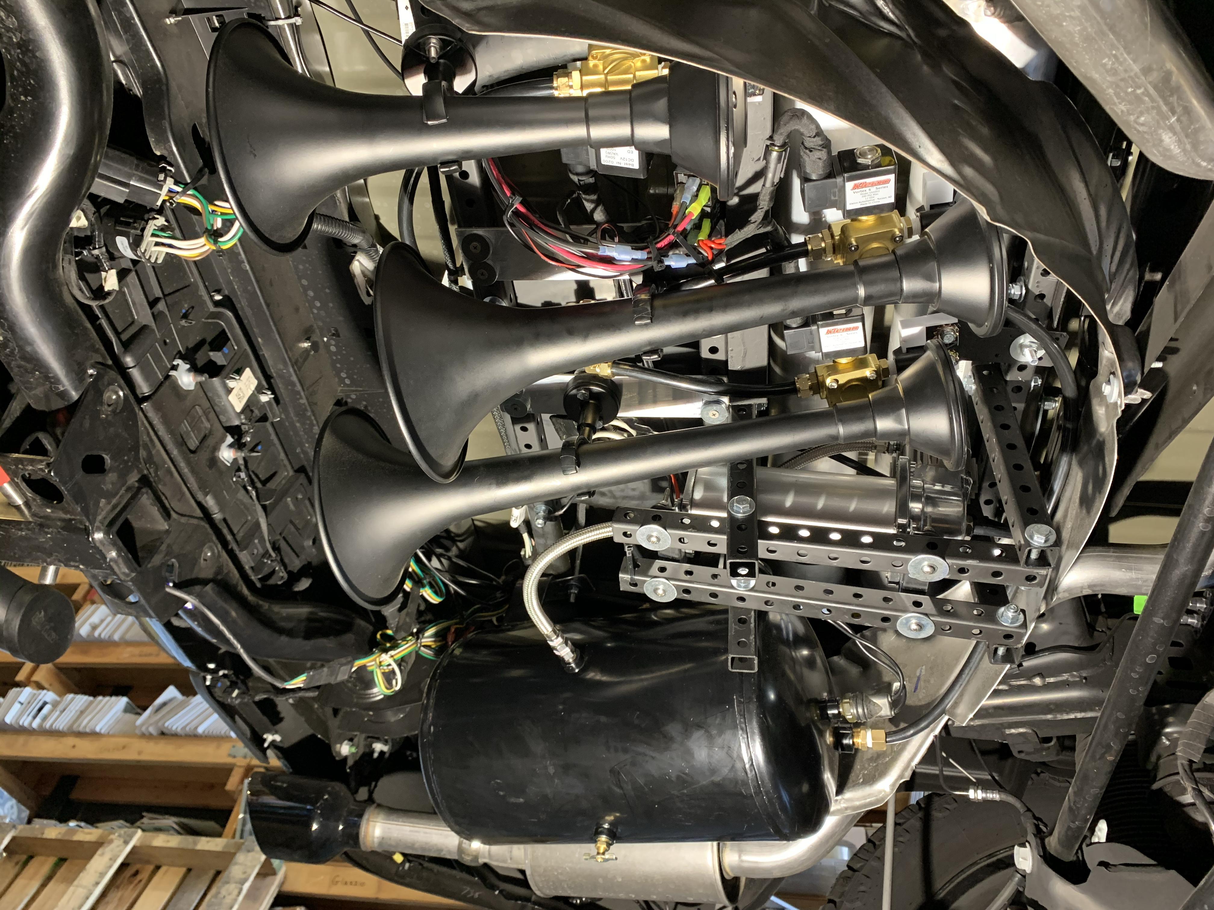

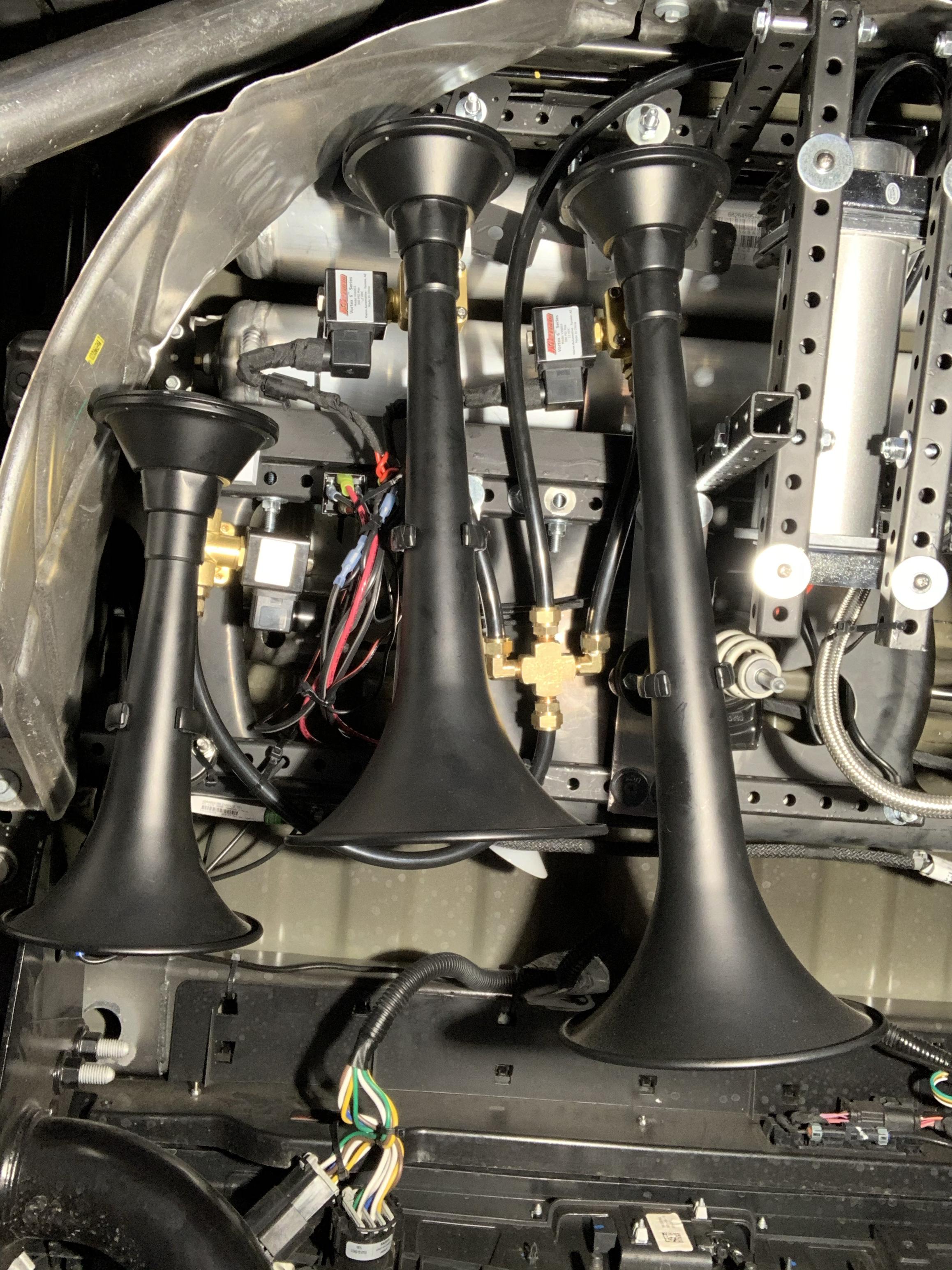

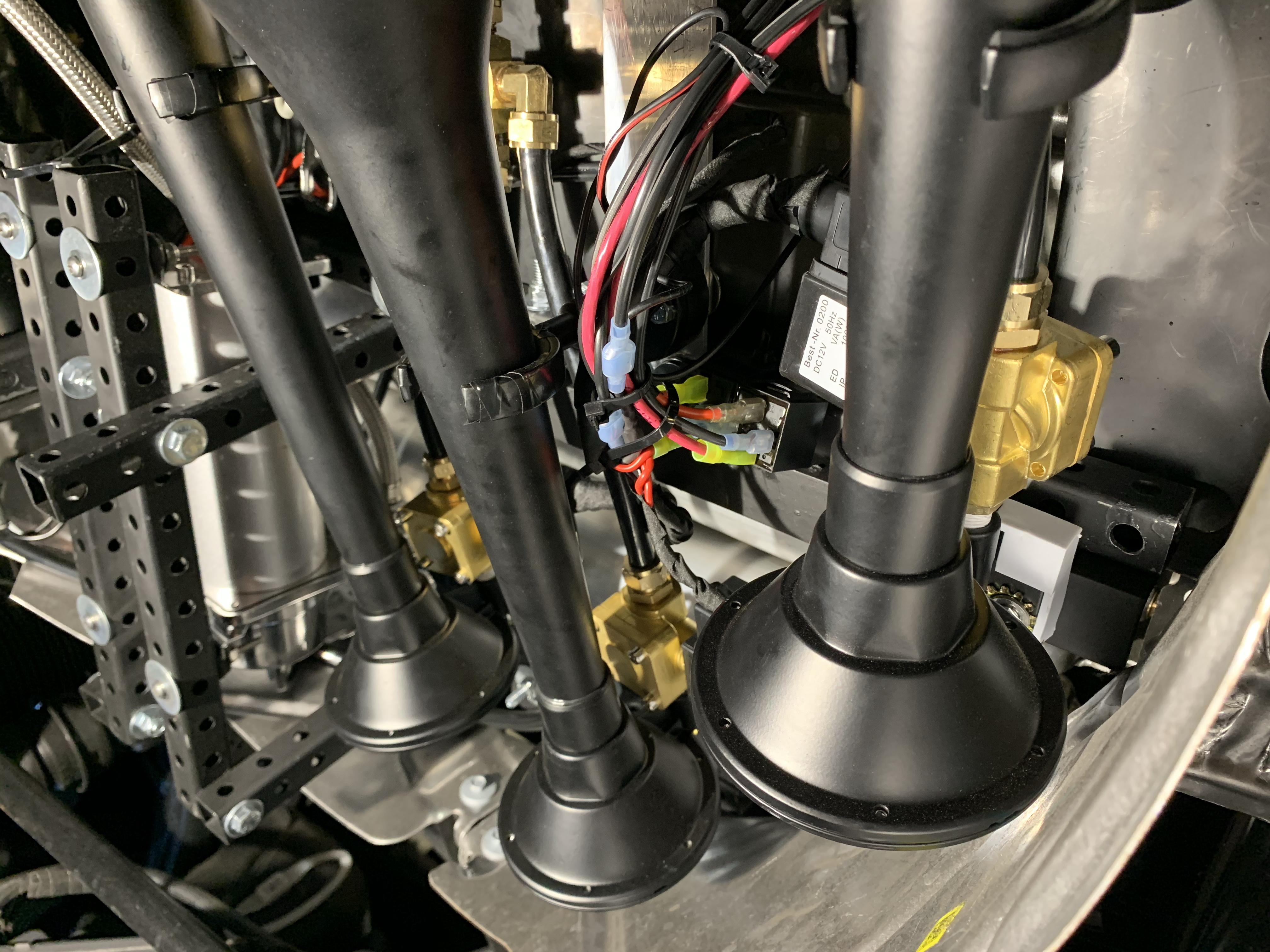

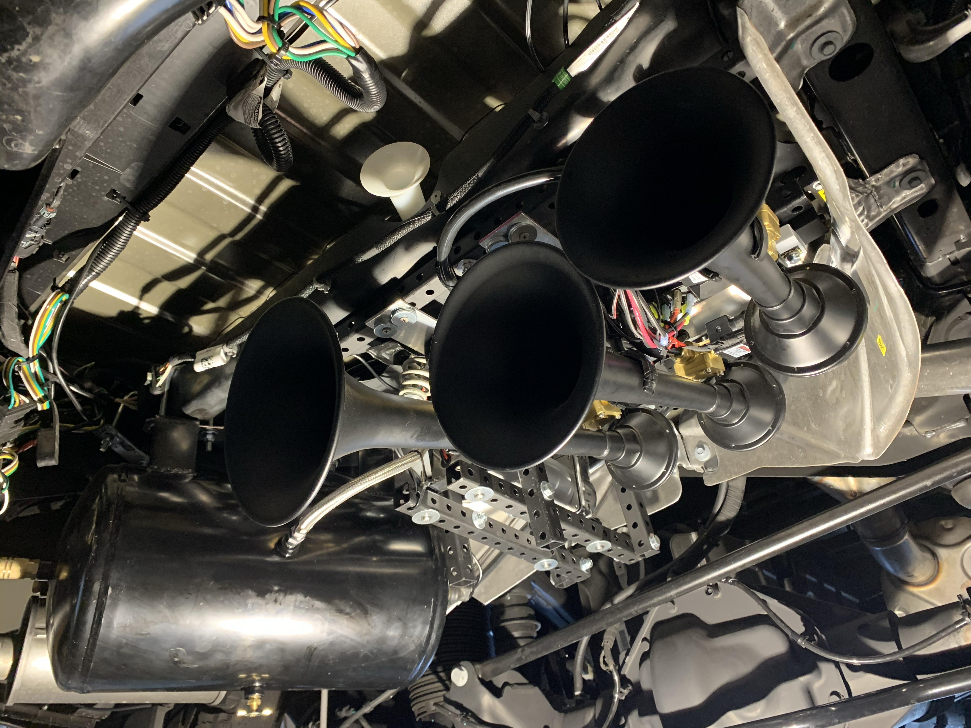

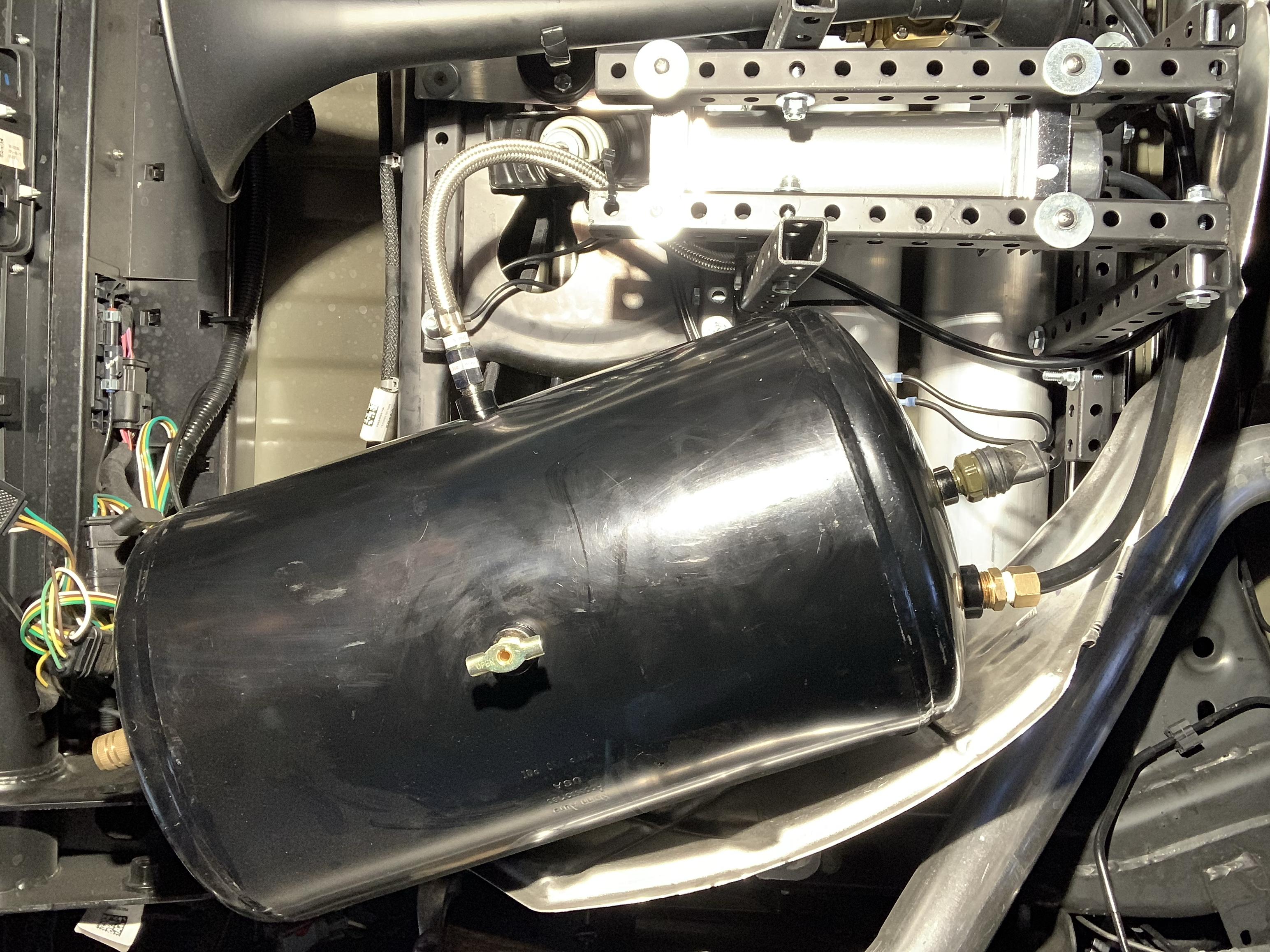

Since I changed my tires to a larger size, the factory spare tire was worthless to me. I wanted to see if I could install and on board air system with a 5 gallon air tank and VERY LOUD and large Train Horns in that space without removing the heat shields. I went with the Kleinn Problaster HK9 - 150 psi System with the demon 730 train horn kit. I also decided to upgrade to the ultra blastmaster valve upgrade. The blastmaster valve upgrade gives each horn its own solenoid with a half inch airline to each horn making them even LOUDER. I figured what the hell, go big or go home! I love the saying on the box that the train horns came in. It states “ Too loud? Too bad! “

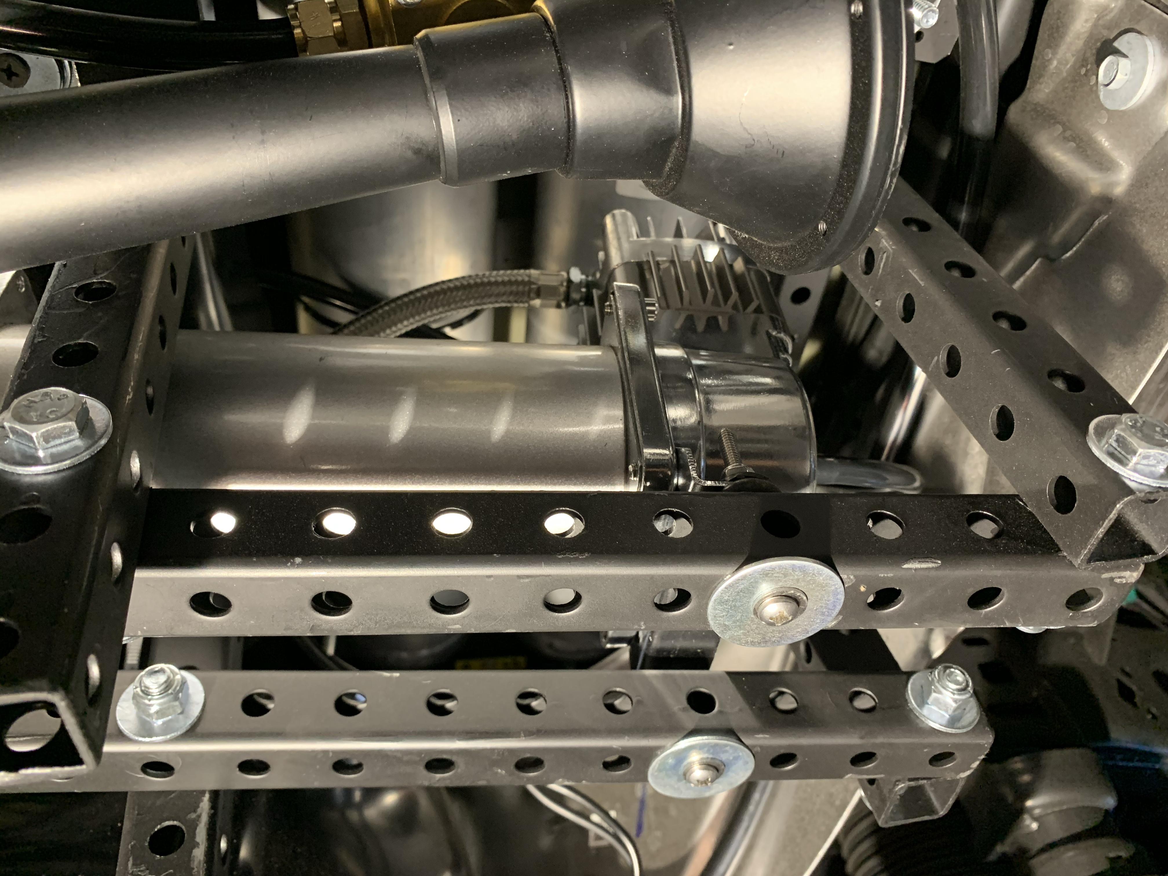

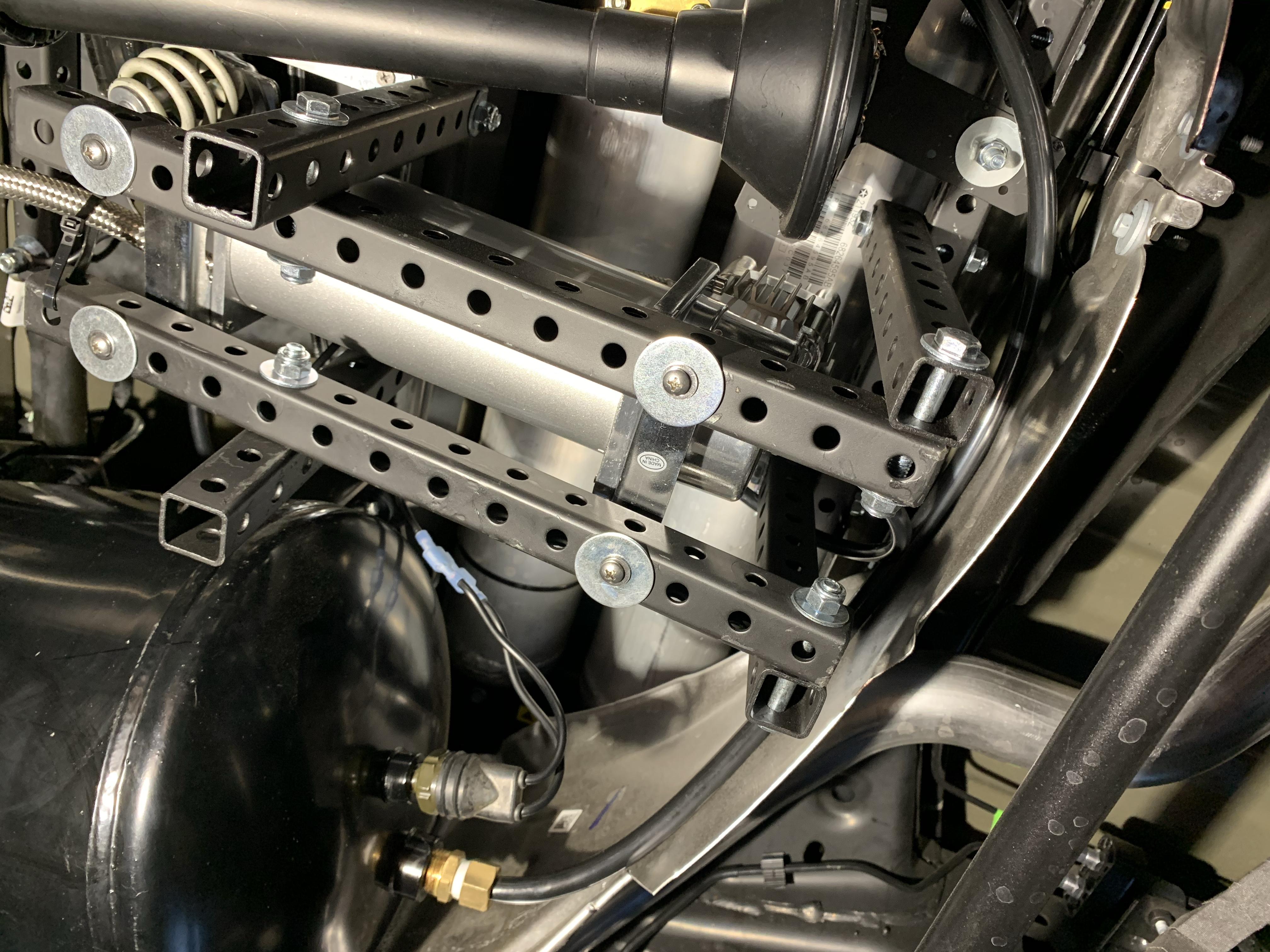

Holy ****, these horns shake the ground. They are so LOUD! The instructions stated not to mount the air compressor upside down due to overheating. So off to Lowe’s I went and bought some metal and brackets and made my own mounts for everything. I am not a welder so I went with the bolt on method. I used nylon locknuts everywhere so nothing should come loose due to vibration

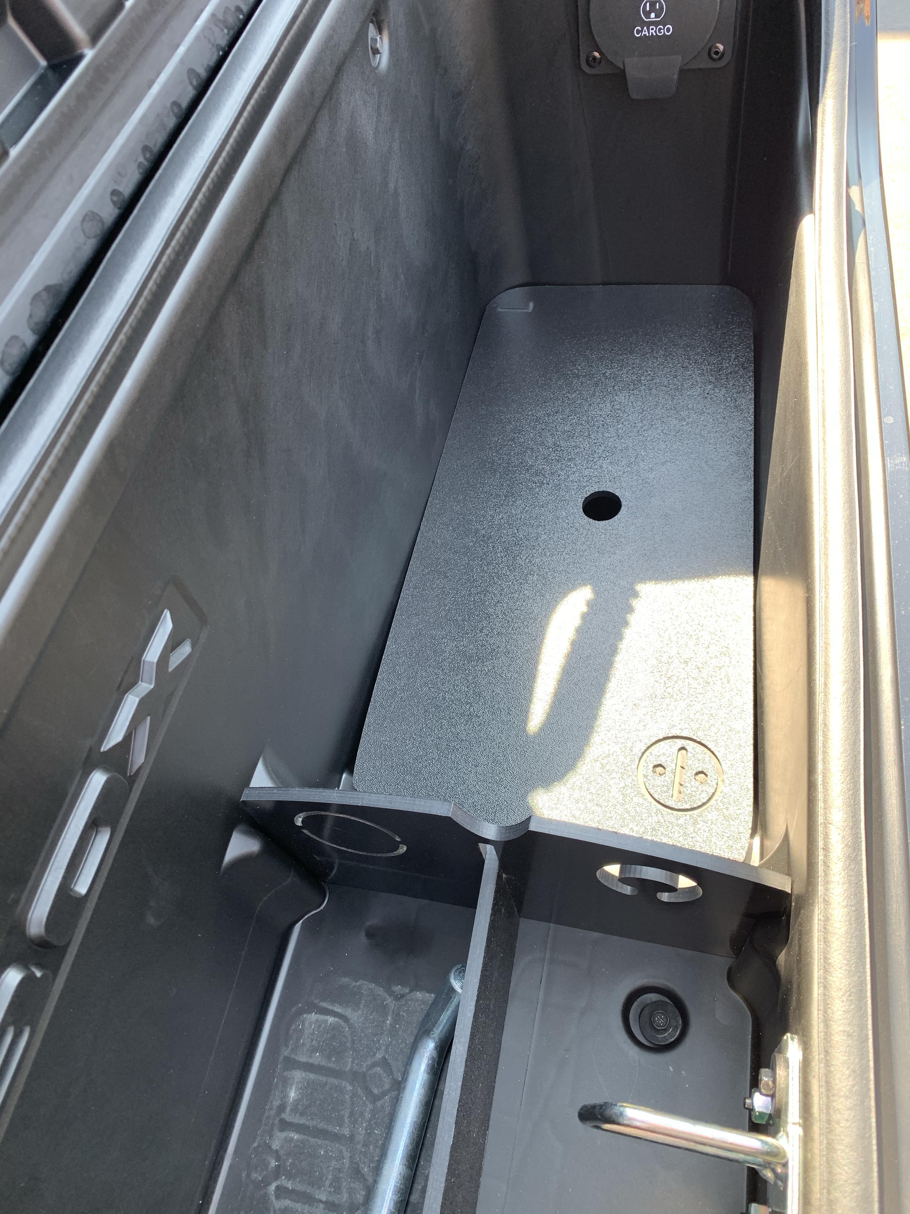

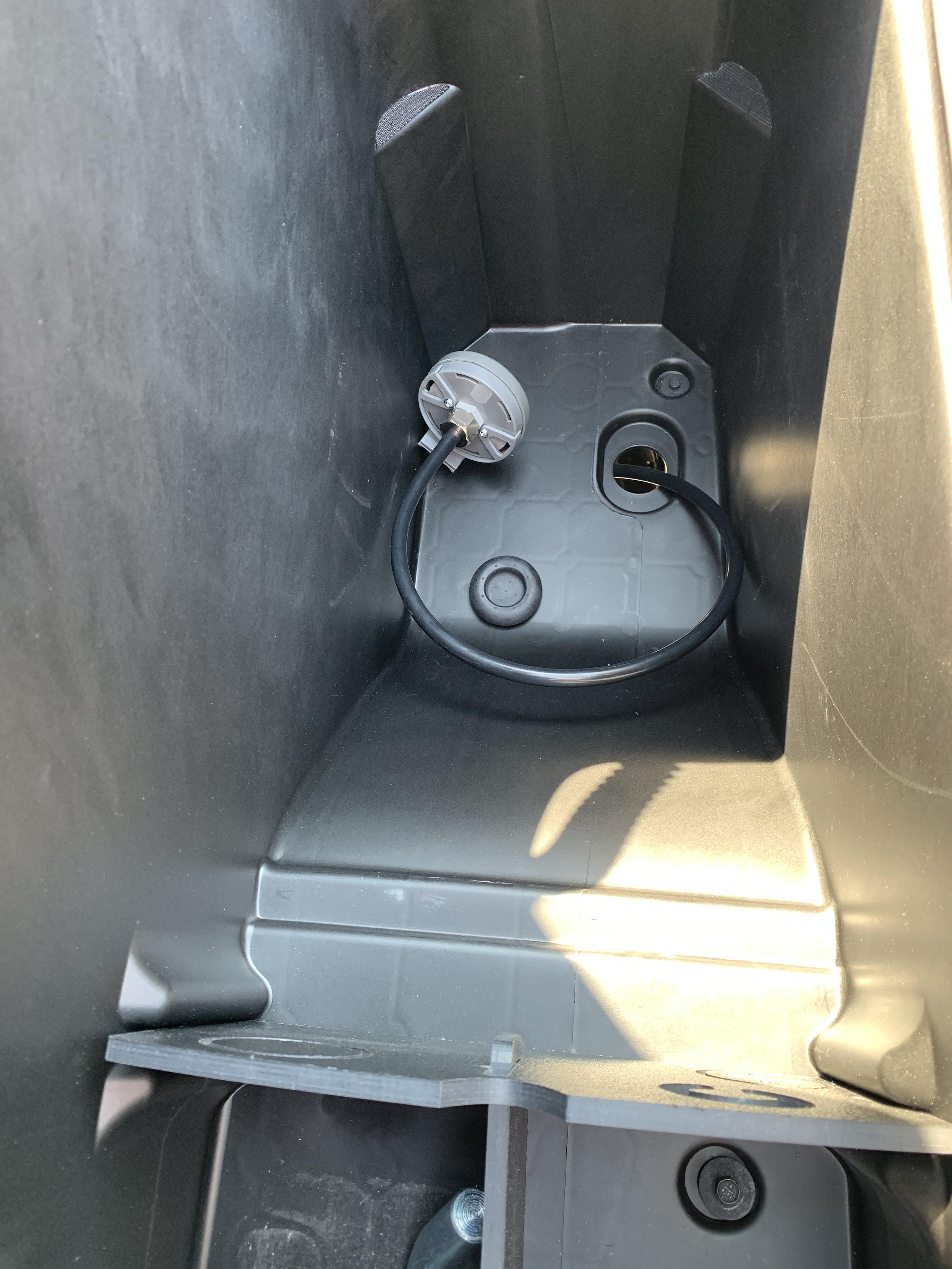

I spliced into the factory horn wire. I wired The air compressor pressure switch and Train Horn solenoids into my trigger 4 Plus 30 amp switch # 1. That way I can turn them on or off as needed. I still have just the factory horn when the trigger switch # 1 is off. I also ran the air filter for the compressor into the driver side ram box. It worked out perfectly because there are grommets at the bottom of the ram boxes. I just removed the grommet and ran the quarter inch airline and screwed on the air filter. Now the air compressor will have clean dry air all the time.
