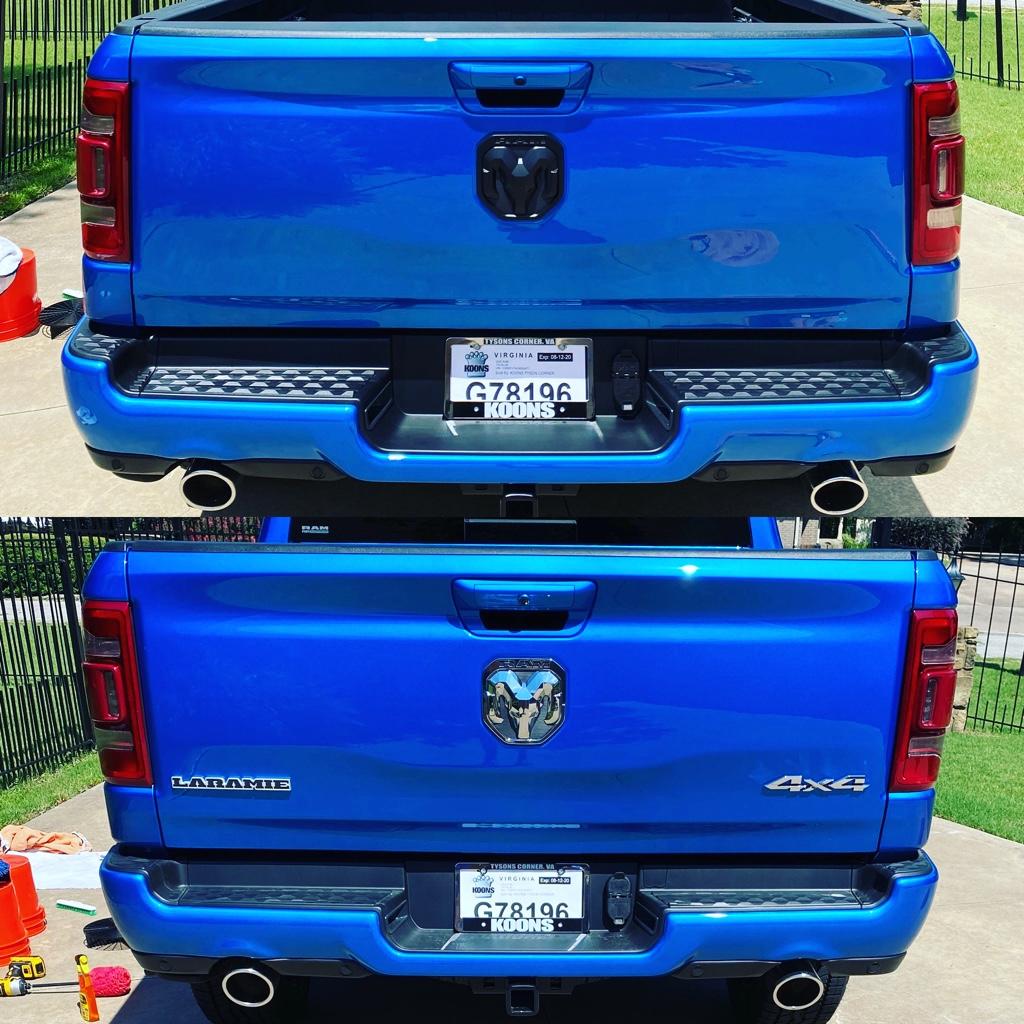

Been a good weekend so far. Had the truck ceramic coated yesterday and finished the red tow hooks today.

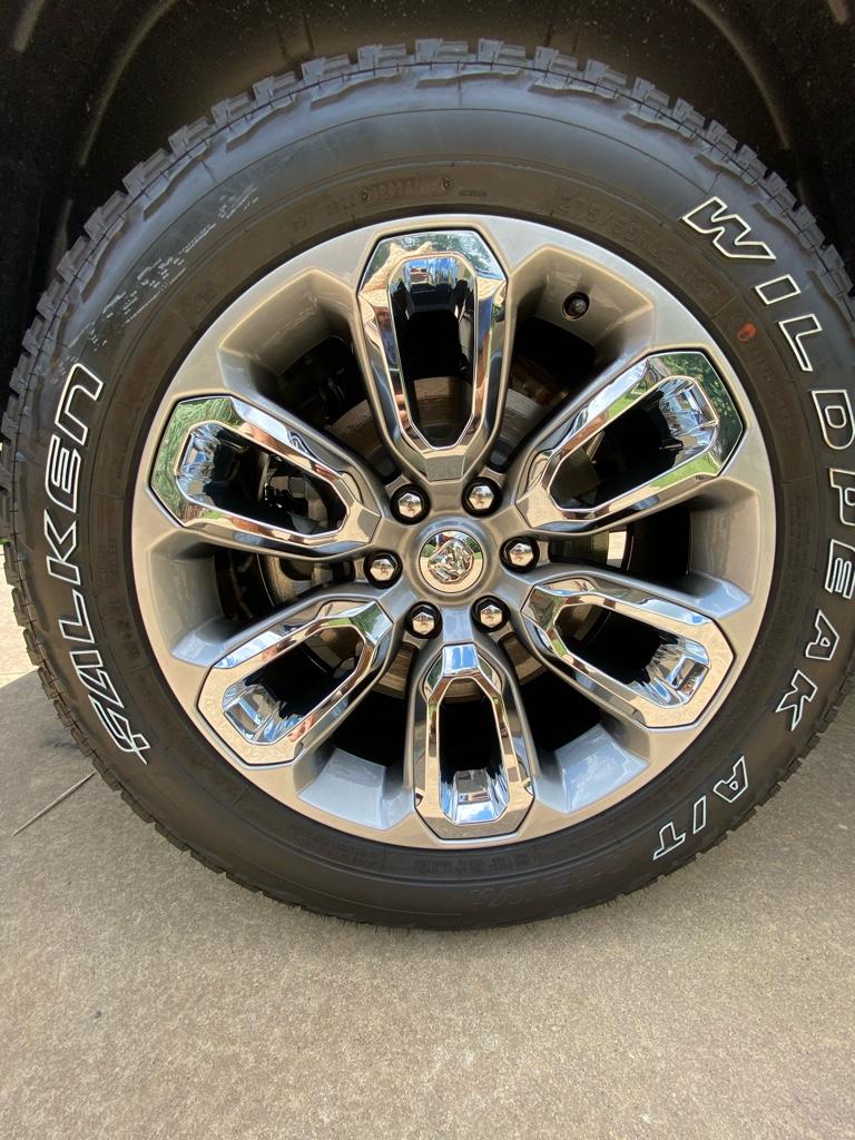

I started to remove badging and change to black. I also used GTechniq Wheel Armour today. I actually am not hating my wheels and I know it’ll be a year before I get new ones so taking care of them as much as possible.
I’ll get the rest of the black badges soon and will probably remove the off-road sticker too.
