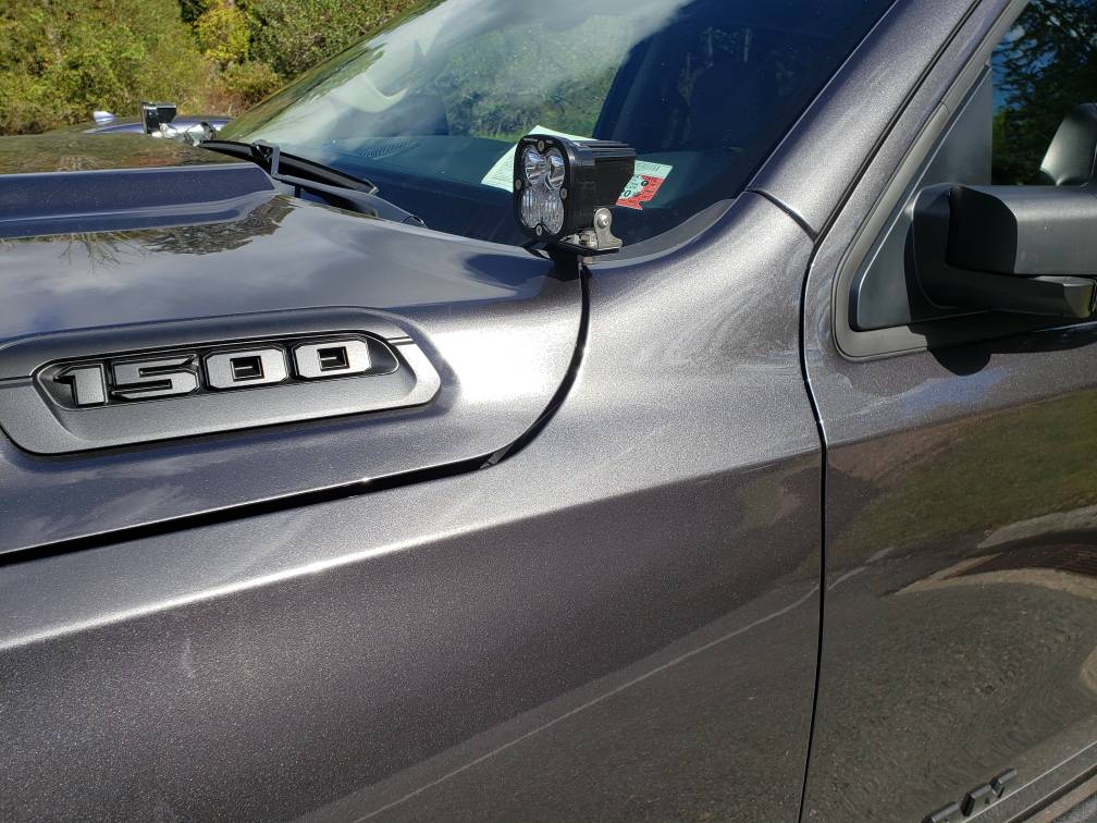

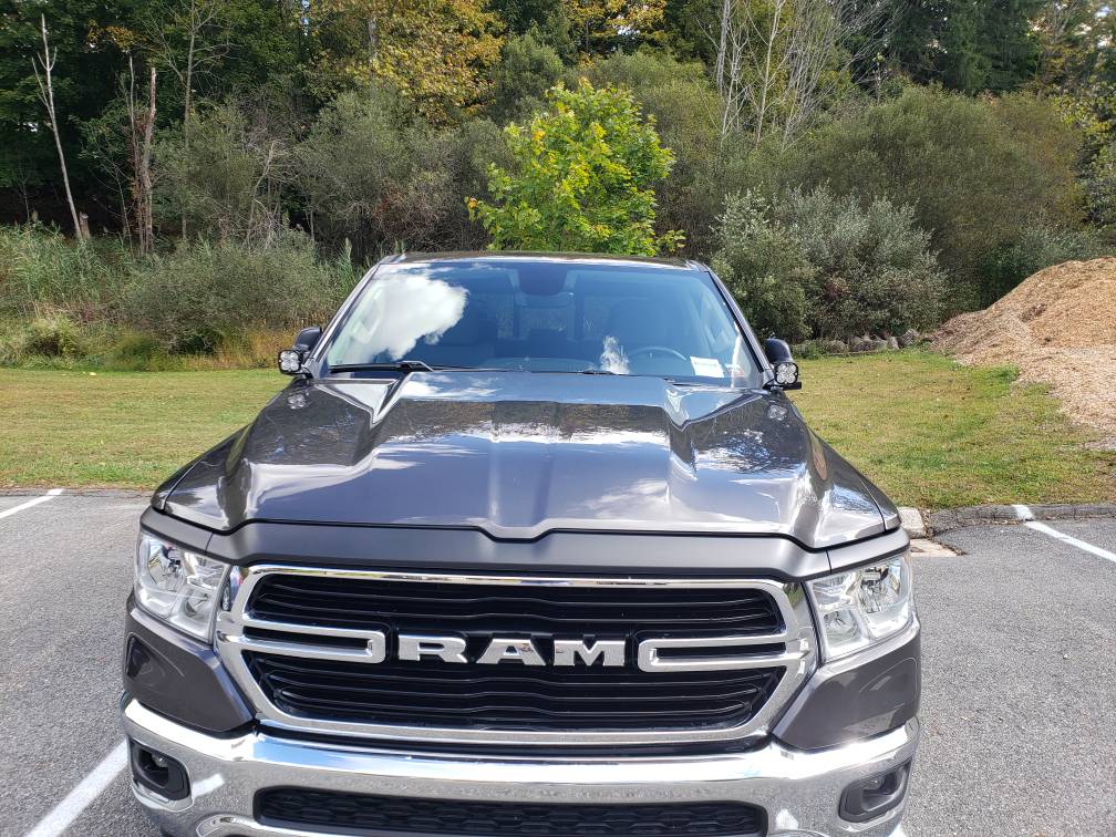

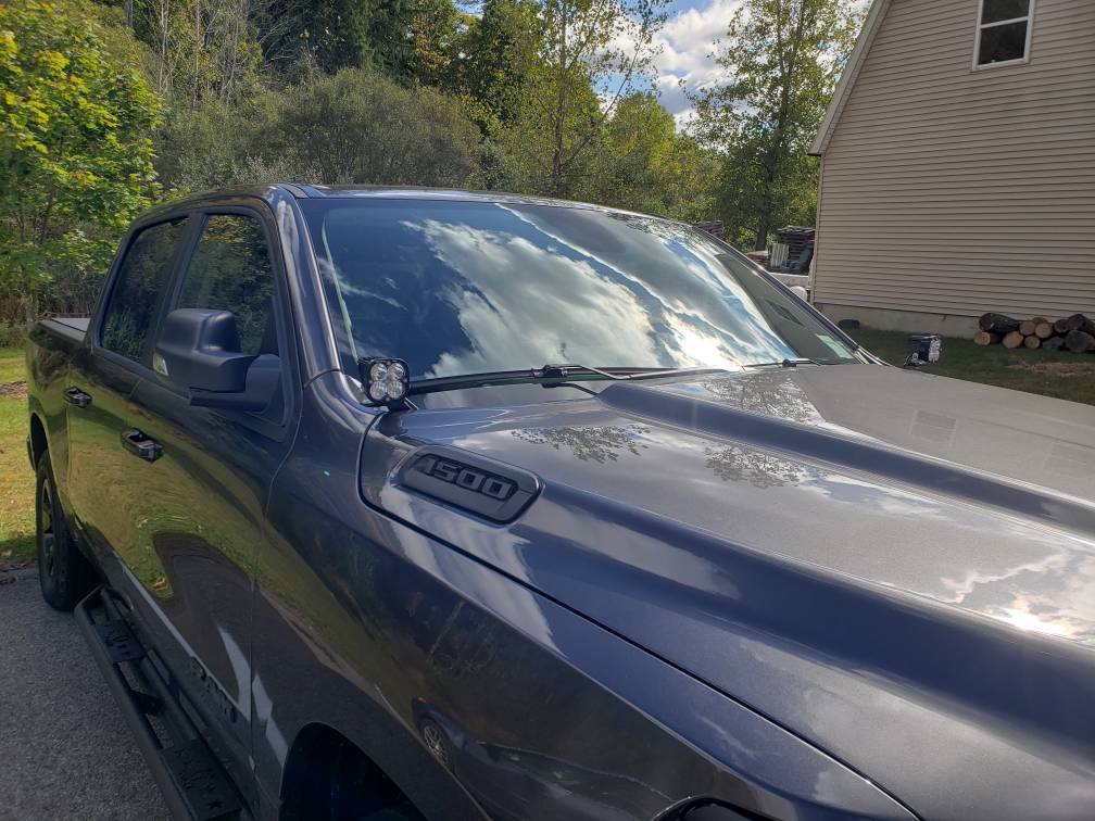

Got my hood lights on today all wired up just need to adjust the angle.
If you don't mind me asking but where did you get the brackets for the hood lights?
Not at all I got them from zroadz. Used this coupon not sure if it's still valid ORE2019 message me if you have any other questions. I also have a guy that gets a deal on baja lights usually cheaper than most.

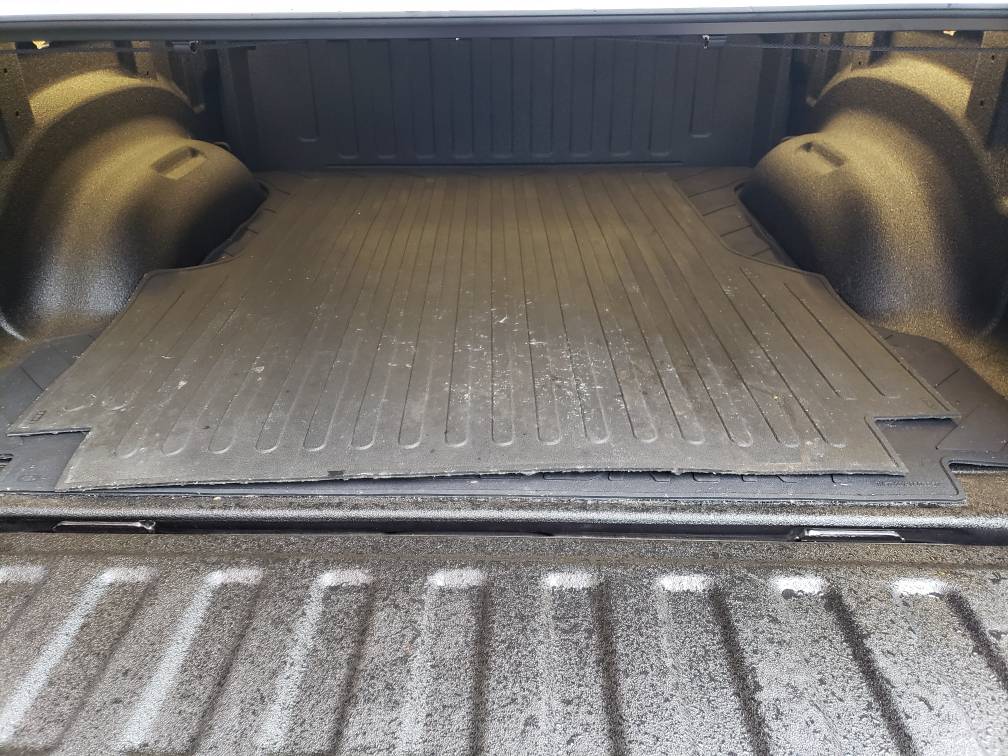

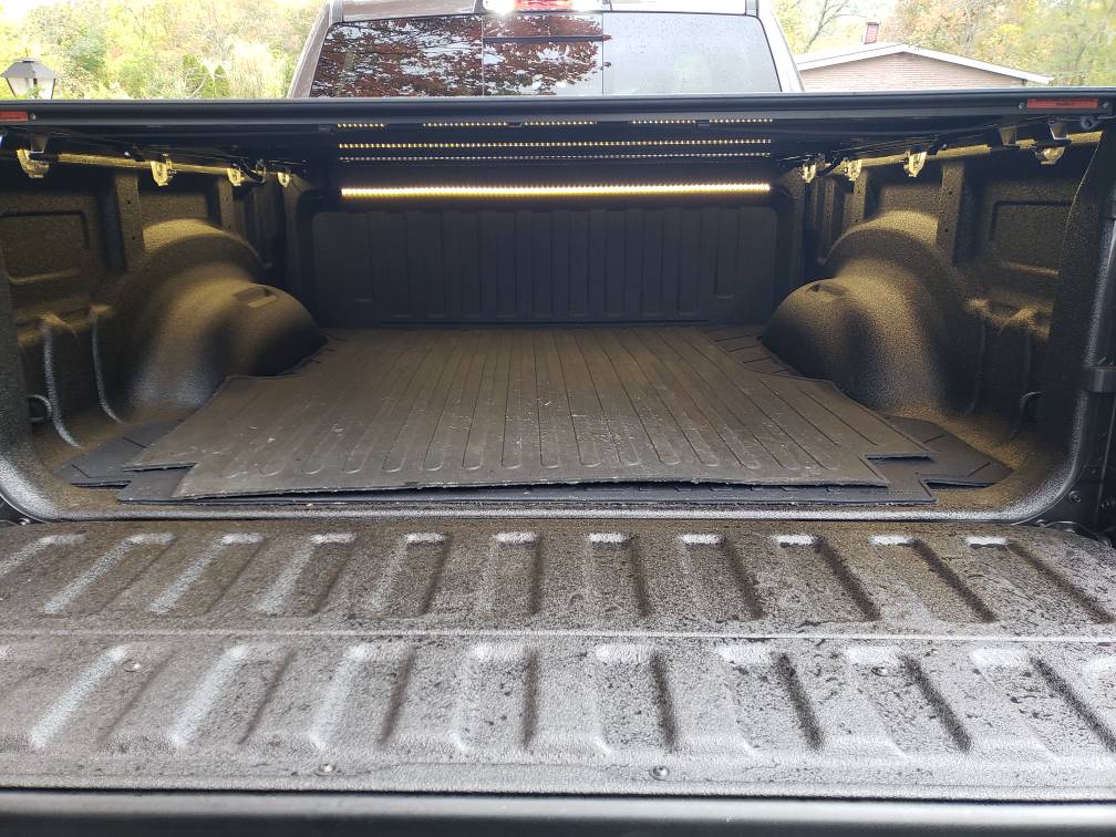

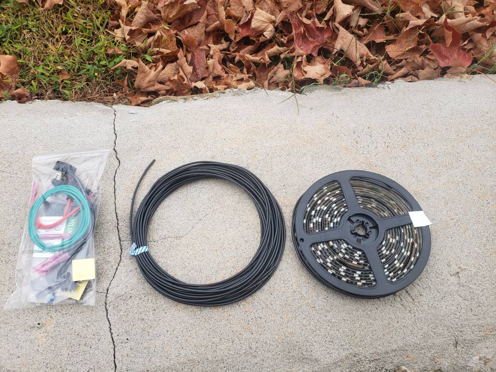

Installed a bed light kit to a switch wish I could figure out how to tap into the cargo light so it turns on when the tailgate opens but I had no luck even after searching.
Think this is the thread you're looking for. Post #57
You could use something like a Mercury switch sensor to trigger the tailgate when it is down, I did that one my 2013. I had exhaust and if you stepped on the bed, so at times it flickered - so I used a PAC TR-7 to create a 1 minute output based on the pulse from the mercury switch, a small delay when closing the tailgate, but never bothered me.
