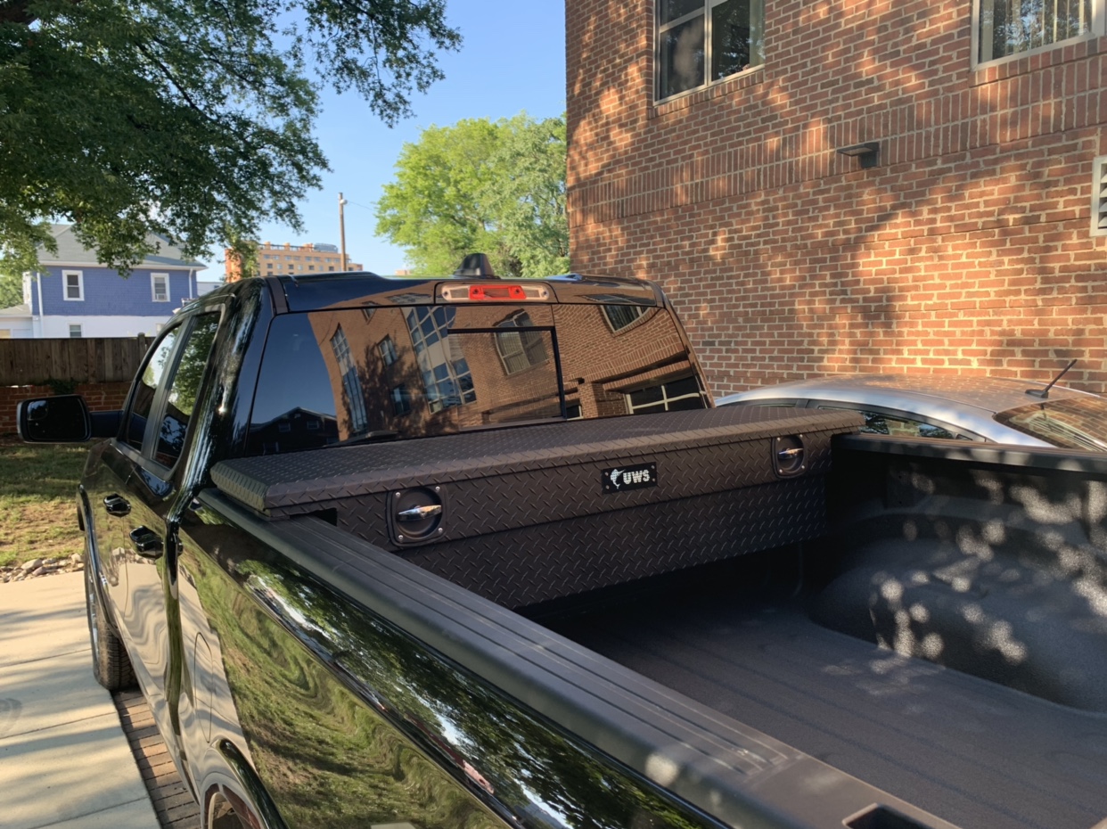

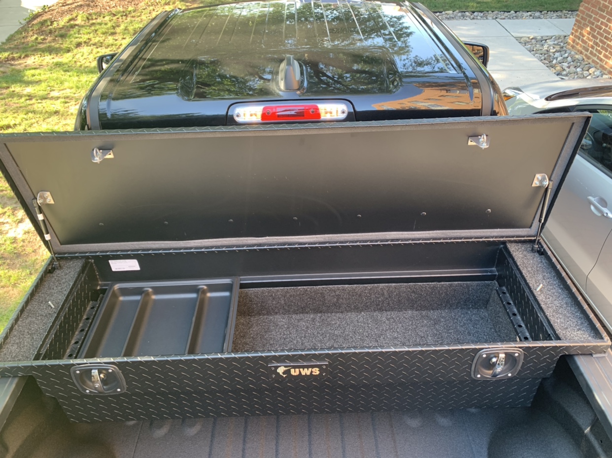

Added a UWS low profile 69” box (72” will NOT fit). Really nice with the security lock handles and removable carpet.

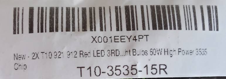

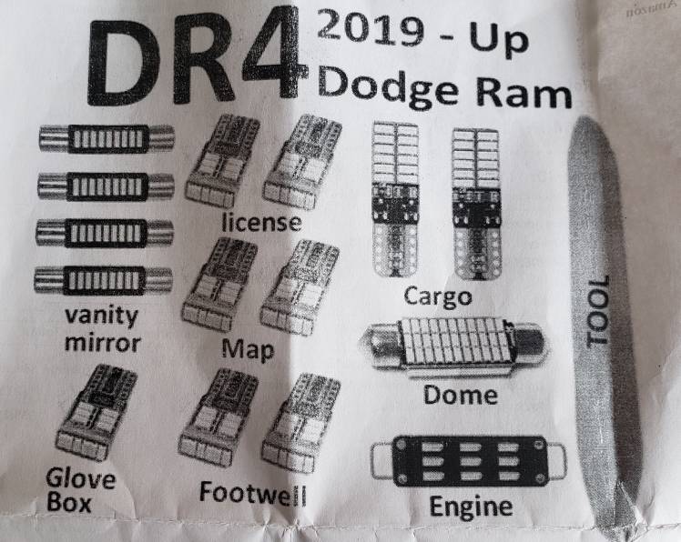

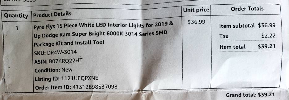

Replaced bulbs, except license plate and glovebox.

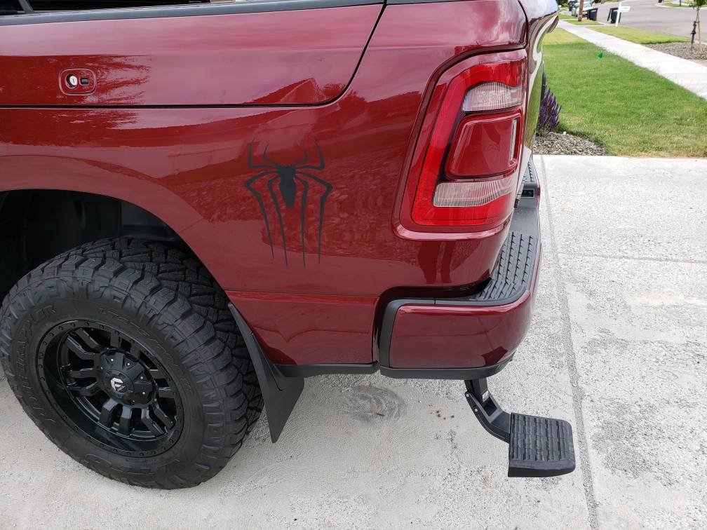

Removed 4x4 decals and replaced with Spiderman logos. Testing concepts for a future, professionally done, look.
Installed Amp Bedstep.

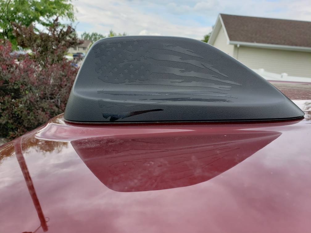

And applied some mirrored distressed flag decals to the shark fin. I think I underestimated how dark the fin was when I picked black gloss; and I might up to the next size and just trim.

Just put a hairdryer on it and start pulling a corner when it feels pretty warm. I realized I didn't have any goo gone, so I used some WD40 to remove the adhesive that was left, then cleaned up with some alcohol. No razor blades were used.How did you remove the 4x4 decals? Hair dryer and razor blade?
