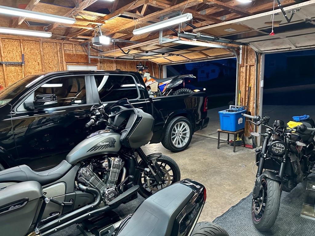

I love having a lowered truck. I can load my bike the night before a ride.
