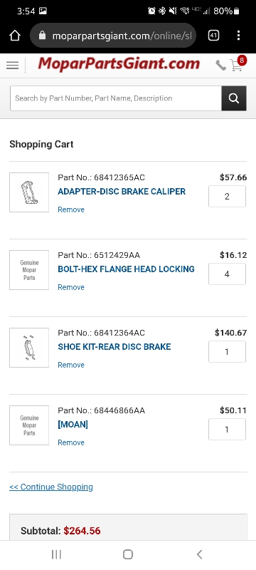

I have this often, typically with just the first reverse of the day that has that loud moan to it. Do you have a link to that kit you purchased? Or how much it was?
Here is the part number
Mine didn't start doing it until it got cold out, like under 40 degrees. I've only had the truck a few months (bought used), so not sure if it's done it since day one.
The kit comes with new, longer caliper bolts, so you don't need to buy those separately.
The kit part # is listed in post #23569 and #23578, open the link. There is another thread on this topic but I'm not sure of the title or name.
Does anyone know if the moan noise comes back after replacing brakes and rotors, but not installing this kit
I would imagine if you went with a pad/rotor material with less iron, it may be less likely to occur. There's also a newer caliper bracket design you can replace if you have a 2019.
It's the one listed on one of the brake moan TSBs.
