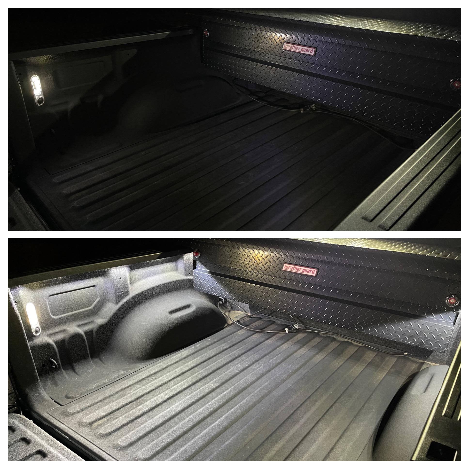

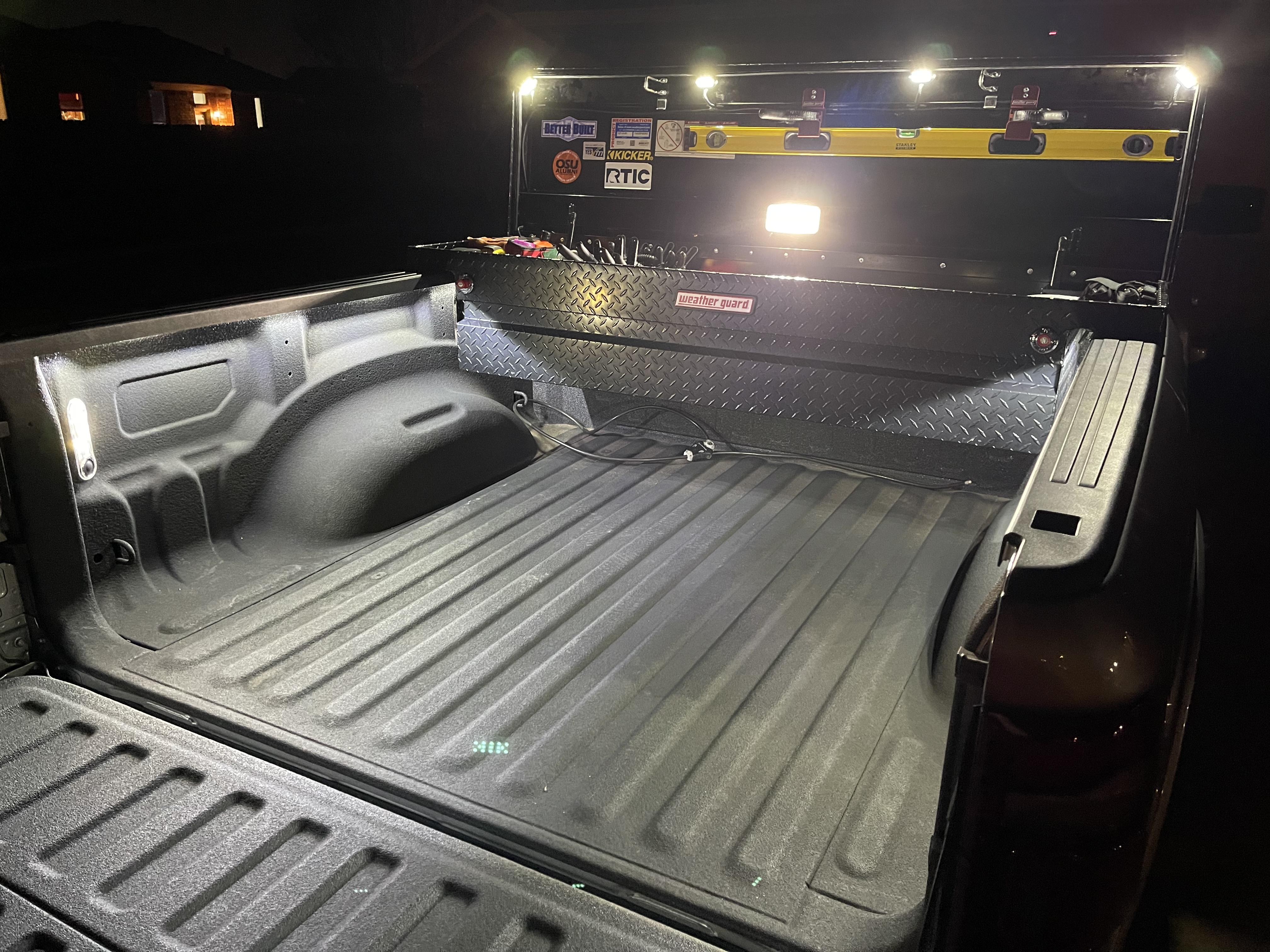

Installed the OEM bed lighting kit ( Part # 82215272AC ) on my ‘19 1500 and used AlfaOBD to reprogram the BCM. They’re not quite as bright as the LED strips I had under the bed rails of my ‘13 1500, but I wanted the OEM look/feel with this one. The latching on/off switch on the driver’s side light is handy, and the controlling of the overhead cargo lights with the switch is a nice touch. Overall pretty satisfied with the outcome, though I’m already tempted to add more underneath the bed rails since the cargo light signal is so easily accessible now.

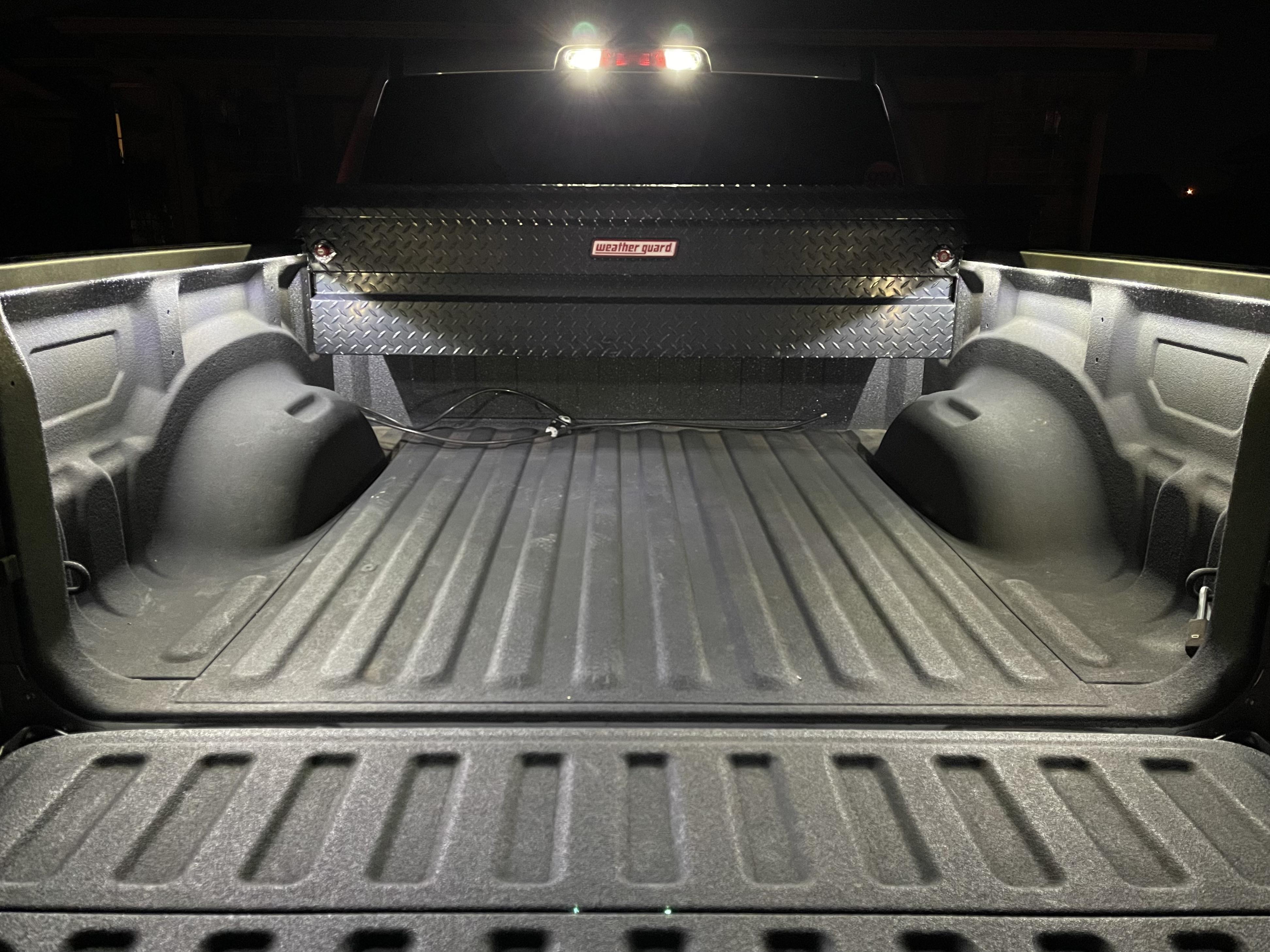

Well I gave in to the temptation and added some LED’s underneath the bed rails, in addition to the OEM bed lights I added a week ago. Now I’m definitely satisfied with the light output.
Before/After:
I went with these pods based off their dimensions, and they fit nicely in the larger flat areas underneath the bed rails. I used these fasteners to tidy up and conceal the wiring. I ran the wiring towards the rear, and cut/spliced into the OEM bed light wiring for power and ground and soldered/heat shrunk the connections. On the driver’s side OEM bed light, I tapped into the two wires (brown/white stripe, black) going to the bottom connector.Did you do the strips or led pods? Do you have a link?
