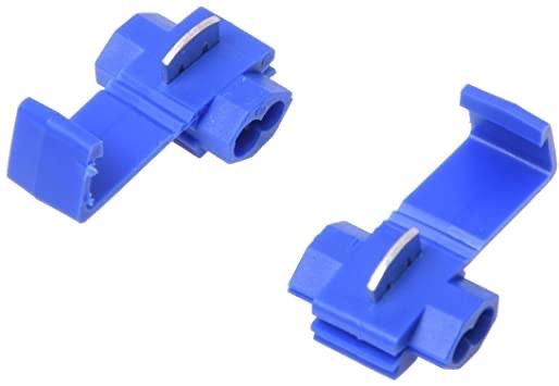

Let me guess. They used those crappy useless scotch lock connectors.
Boston
Aug 9, 2019
427
168
Isn't that the same as scotch tape? Lol
These evil things.
