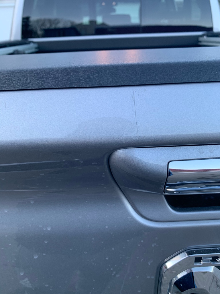

That’d be great if there was a way. I parked backwards at work one time, I remote started my truck while inside... or so I thought... then I get in my truck, turn it on and leave, and I felt the tailgate open as I pulled away... it had open and while I was pulling away it was just going down the wall. Nothing crazy but there’s a slight scratch. Very irritating

This is what happened to it, not major but still a ding
