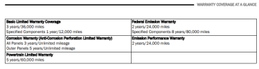

The battery is covered under the 8 year 80k miles federal emissions warranty.
Main parts are the generator and battery pack. Other items would\should be cheaper to repair if there even is anything (belts?).
Ram explicity says their warranty will NOT cover ANY of the hybrid parts whatsoever, so I bet even if you had Maxcare to 100k, from 81k+ miles they wouldn't be covered.
One of those scummy after-market protection plans might cover it but they are not "warranties".
Maxcare isn't a warranty, it is a service contract. Thanks for posting what the warranty is from factory. Please inform us all what Maxcare coverage is.
So you are claiming Maxcare (which is a FCA product) covers eTorque parts after 80k miles?
Please do share.
Cbty2050
Dec 26, 2021
1,835
1,229
Please do share.
They list what is not covered....

I confirmed with Zeigler last week that etorque is not covered under any Mopar extended warranty. It falls under the federal emissions warranty, 8 years/80k. I was working with them on a quote for max care and specifically asked the question.
That's what I thought.
You are saying nothing in the etorque system would be covered because it's covered by the 8/80 emissions warranty.

Im no expert, but it could mean that IF a part is covered by the 8/80 emissions warranty that takes precedent over the maxcare service contract? The same applies to ALL parts covered by the 3/36 warranty. A lot of those service contra have lesser terms. Only the 8/100 and 8/125 would exceed it, and then only by mileage.
maxcare effectively covers nothing for the first 3 years 36k miles. and then doesn’t cover your powertrain until 5 years/60k miles because the powertrain warranty covers that.
Maxcare is just coverage that kicks in after other warranties expire.
