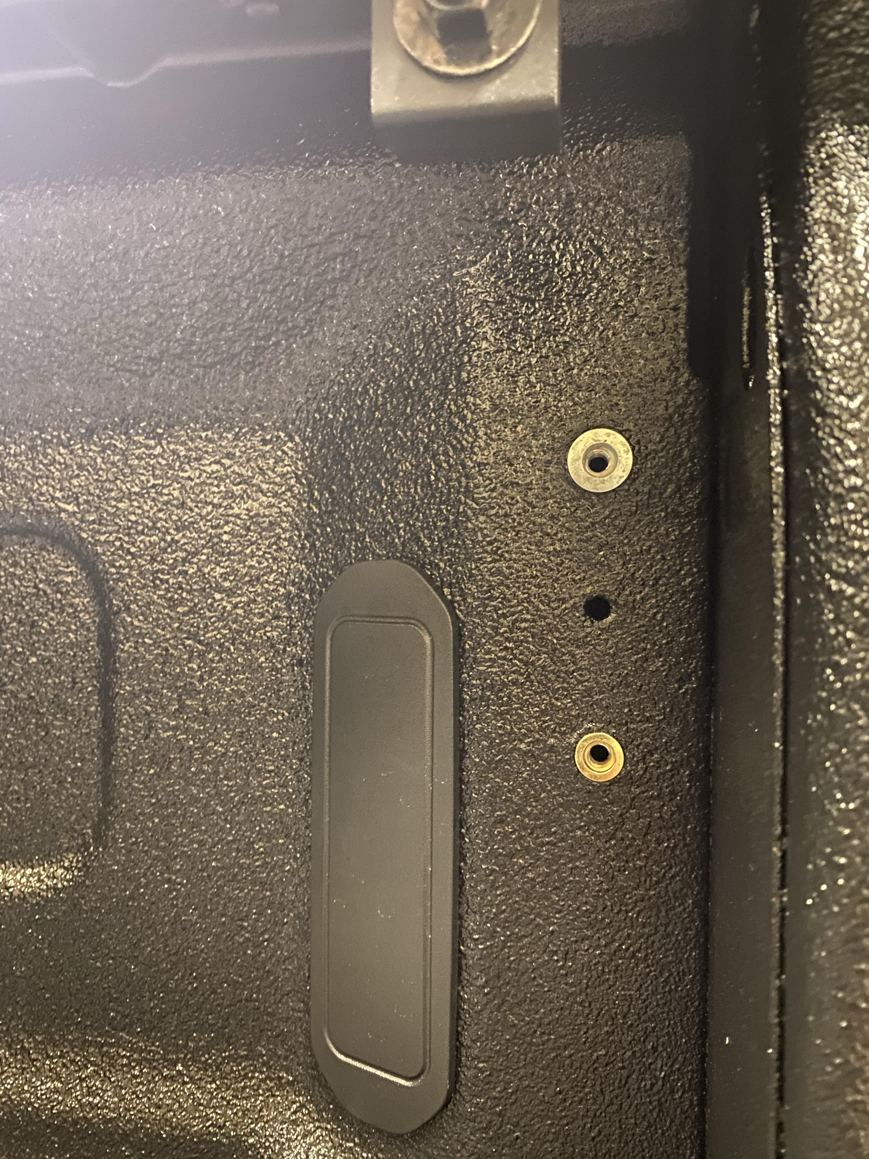

Bumping this thread. I just ordered the utility bed rails and a nutsert tool. My bed was sprayed with Line-X so the holes appear to be round. Will I be able to install the nutserts with the tool, or do I need to "enlarge" the holes first?

I bought an Insert tool from 4 wheel parts and it seemed pretty well made by smitty built, however I still had to go to each hole and clean up the bed liner with a small square file
I put the rails on mine a couple weeks ago and the holes were a tight fit for the hex shape and I DON’T have a bed liner sprayed in mine yet! I was worried about this exact thing so wanted to put these in before getting the liner.

Line-x spray and I tried the method using a bolt and two nuts nut gave up and ordered a rivnut kit from Amazon with next day delivery and had the rails installed in no time with the kit.
Same here. Ruined two of the included nutserts too; had to use some of the included ones from the kit.
