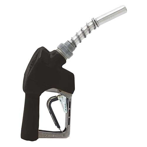

Anyone else running into this even after the "reworked" fuel neck design is swapped in so gas pumps won't get stuck in the truck?
The fuel pump still gets stuck in cap less gas tank, Still takes a half hour or more trying to get the gas pump released from the truck.
Yes, dealer did the new filler nozzle "update" a few weeks ago.
I even took the tech from the Ram dealership down the street to the gas station with me to show him what happens, even with this new gas filler neck design.
Got stuck with him there. He had to pry the pump free with a screwdriver.
I left the truck for three days at the dealership so they could open a star case.
I'm told the star case techs don't know how to fix it.
Ram corporate told the tech to tell me to use the funnel that came with the truck for gas can fill ups, when I'm actually at a gas station to fill the truck.
To attach the white funnel between the truck and the gas pump nozzle.
There is NO way for someone to do this without putting themselves at risk.
The funnel is not flat at the end the pump would go up to it. So, you have to pull back the rubber cover on the gas pump so it thinks it's up against something flat before working.
Then, you have to put that gas pump tip in the funnel you have already inserted in the truck filler hole.
Then, as gas is flowing in, when the gas gets near full, there is no way for the pump to know that to shut it off as you're already tricking it to work, while balancing the pump in the funnel and holding back the rubber cover around the nozzle just so.
Therefore, gas flies back out through the funnel, all over you, the truck etc causing hazards.
And, that is Ram corporate’s idea of a solution currently.
I still smell like fuel, two showers later today.
I love this truck, just want to get this figured out.
Therefore, I'm looking for answers of how to get it fixed right at the dealership if by chance others have had the new neck put in and have run into the above as well and then got a resolve to it.
This is in California.
And, it seems to happen most often at newer Shell gas stations. I want to make sure it's sorted asap and definitely while under warranty as knowing California, this pump style causing the problems will likely be made mandatory statewide in the future!
Plus, you should be able to pull in anywhere and get fuel without the fear of this possibly being the pump that you won't be able to get free from at all. @RamCares
Thanks.
