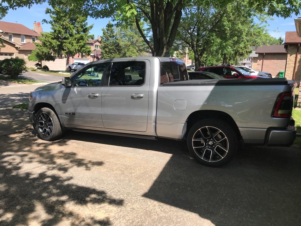

Nice looking truck. I was looking to get the 20” aftermarket rims, but same as you didn’t want to spend more less $2000, plus a probably another $2000 on set of tires. And going through headache of selling my current rims. The only advantage would be more tires options with 20”. Since I like my rims, just gonna have to spend ~$2000 on Nittos. I do have 3.92 gear so I hope it will be ok with LT E rated tires. They are at 63 lb , so only 80 lb more in total than my stock Goodyear’s.
Thank you very much, it was between the truck I ended up with or a Red Rebel with Red Interior which I was really debating on going with. Ultimately I wanted the pano-sunroof and heated/cooled leather seats and I loved the colour (almost went with the tri-colour white) Both had the 12” screen. I figured if I want to go higher like the Rebel I can do it at a later date. And here we are lol...
Your it looking pretty nice. Looks like you have the power steps that’s a nice addition.

Thank you, love this truck. Yes I do have the power steps. This is the colour I wanted, and I wanted a 6’4” bed, which was very hard to find. I don’t have 12” screen and sunroof, but it wasn’t a deal breaker. I do have the vented seats, which is very nice feature specially right now.
