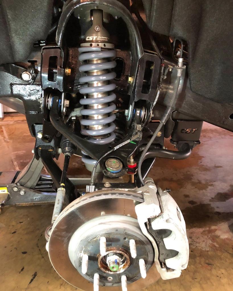

This was my last 2017 truck after 4 years of northern pa salt brine winters and acf50. Everything cleans up so nice. I would spray it down in the fall and in the spring I’d wipe it down.

Yeah one can is good. And it’s kinda oily so not really. When I would put my summer wheels on I would just wipe it off my coil overs and they looked like they never saw salt

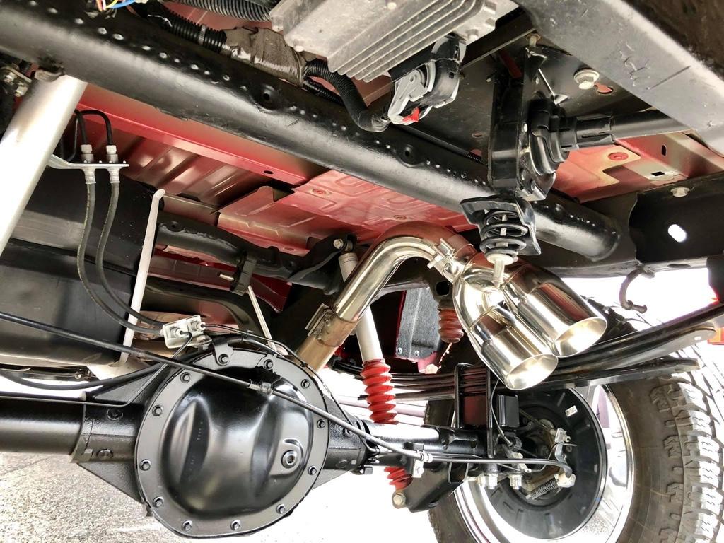

I coated my undercarriage with ACF-50 this afternoon. I covered a 10' x 20' spot on my garage floor with plastic so I wouldn't get that stuff all over my concrete. I coated the rear end, suspension components, frame, and hitch. It took me 1.5 hours with the aerosol can. I had to spray it on and then spread it around to coat everything evenly. The aerosol can sprayed the product out in a narrow stream that splattered quite a bit. When I do it next time, I'll buy the 32 oz. bottle and apply it with a pump sprayer. With a pump spray bottle, I think I'll be able to apply it as a mist and coat the surfaces more evenly without having to wipe it down.
