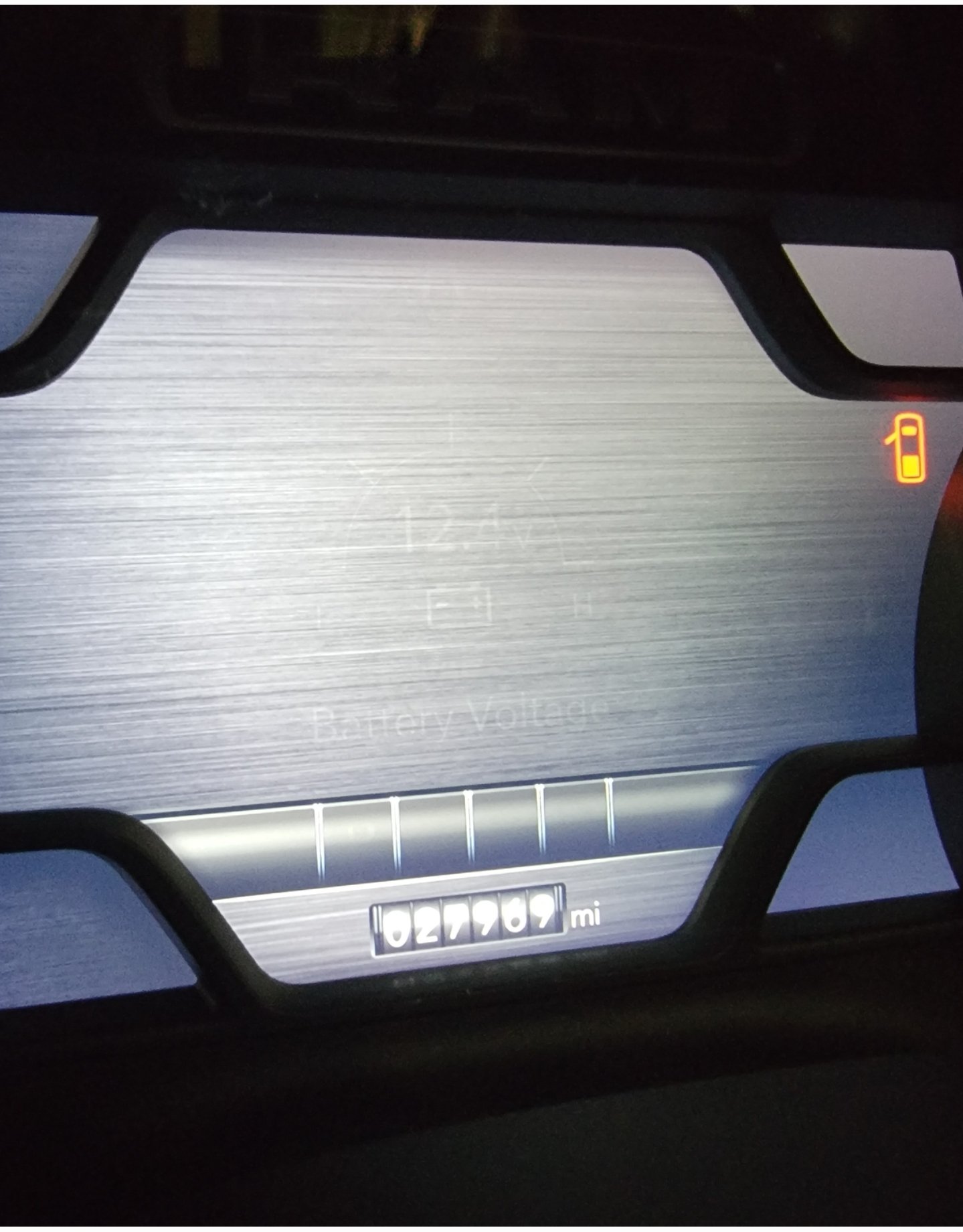

My radio doesn't do it, but my gauge cluster screen does. But not all the time.
Interesting... I'm thinking this is a software issue. It's definitely not burn-in like I think my dealer thinks it is. The images aren't permanent. That's why I don't think a new screen is going to solve my particular issue.
Ldc2335
Aug 16, 2021
310
502
Agree. Definitely not burn in.
