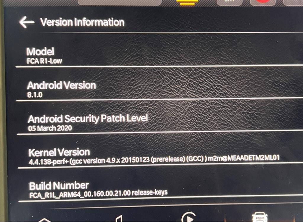

can you post a picture with the current version number?
Here's mine
