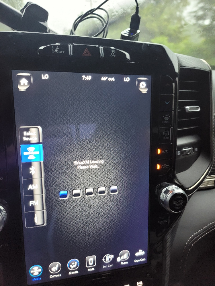

I personally haven't heard that. The last thing that I was told (in April) was that I had the latest firmware and that they were ordering a replacement unit for me. Since then, both the dealership and Ram Customer Care refuses to respond to my inquiries. I've been being ghosted for over 3 months. Maybe they're hoping that they can continue ignoring me until the warranty expires -- then it's not their problem anymore.Dealer said RAM is working on a software update to fix this issue but it has not been released. Has anyone else heard this? Will update if/when they notify me about release.![]()

Would you care to share the detailed instructions from UConnect on performing the soft reset on the 12" HK system? The typical instructions for holding the Power/Tune or Phone/VR buttons for 30 seconds haven't effected a reset on my N3GL system.Talked to UConnect today. Gave me detailed instructions on how to soft reset my 12" Harmon Kardon system. Not near vehicle at this time. Also instructed to go to dealer if radio did not properly reset and ask for software download of version NR28.1 and tell them this is data from Dealer Connect, if any hesitation. From what I see here, this problem arose after a failed OTA upgrade back around Xmas time.
I second this emotion!! As far as we all have known for quite a while, there is no way to do a soft reset with any button sequence on the 12 inch radio. HK or not HK. Not sure what difference that would make for a soft reset anyway.Would you care to share the detailed instructions from UConnect on performing the soft reset on the 12" HK system? The typical instructions for holding the Power/Tune or Phone/VR buttons for 30 seconds haven't effected a reset on my N3GL system.

Did you ever use CarPlay? Mine only goes bat crazy after using CarPlay.I have the same problem in my 2020 2500 Laramie since new (purchased in Dec 2020). Locks up on SiriusXM "loading" screen about 1 out of every 3 starts. I've tried but failed to come up with something that's common to every failure.
Regardless, I finally got to take it to the dealership in April to confirm the problem. Fortunately, it locked up when I started the truck to head out there, so confirming the problem was a no-brainer for them. The tech checked some stuff and told me that I had the latest firmware so they could skip the part of the instructions that said to flash it and go straight to replacing it.
Fast forward to mid-July. Still no replacement radio. I happened to be at the dealership for a state inspection on another one of my vehicles when I asked about the status of the replacement radio. Service advisor made a lot of phone calls and said he'd get back to me. That was two weeks ago. I've called them multiple times and they still have no information as to the status of the replacement. So I called Ram Customer Care. Even *they* blew me off, telling me that they don't know anything more than the dealer does.
I realize that there's a class-action lawsuit over this 12" UConnect hunk of junk (which I am not a party to), so I'm wondering if that has something to do with the radio silence on the issue?
This is my 4th Ram and I love the vehicle in every other respect. I personally wouldn't have ordered the 12" UConnect (I was happy with the 8.4 in my previous truck) however I bought it off the lot and got whatever the dealer ordered on it.
Regardless, is there any way to get Ram to actually respond to me on this issue or fix their problem in a reasonable amount of time? Or should I just keep reporting it and hope I can engage the lemon law? Or perhaps engage an attorney?

I never used CarPlay -- I have an Android phone. I did try using Android Auto once, but the problem manifested itself on day one of ownership -- long before I ever tried Auto. To be honest, I'd have been happy with the UConnect 8.4 -- I had that in my last few trucks and it worked fine. I only have this 12" because that's what the dealer ordered and I bought the truck off the lot. It's certainly nifty, but if it's a crap-shoot as to whether it'll work when I start the truck, they can keep the fancy-schmancy thing.Did you ever use CarPlay? Mine only goes bat crazy after using CarPlay.
I got into the "dealer menu" by pressing and holding the two outermost *soft* buttons simultaneously -- in my case, it's the "Media" and "Backup Cam" buttons. According to my dealership, though, I already had the latest firmware and they skipped flashing it and went right to ordering a replacement. The dealership already had the latest firmware flash back in April (which was equivalent to the version on my old unit), so not sure why you're being told to wait on an update unless it's an even newer version of the firmware than I had on my original unit.+1 for having the SiriusXM Loading issuePurchased a new 2020 Longhorn with the Uconnect 12.0-Inch screen. Truck currently due for its 25,000 mile service. Each service I take to the dealer and mention the radio problem. Service department tells me it is a known issue and they are waiting on a software update that seems to never come.

@Gort - thanks for the info on how to get into the "dealer menu" for the radio! Very helpful. Attached is screenshot of my current radio info.
I called and spoke to the Service Manager at the dealership where I purchased my Longhorn. He suggested having the radio replaced.
He gave me a phone number (1-800-247-9753) for Chrysler Care and suggested calling them.
I called Chrysler Care and got a case open. The person I spoke to suggested telling the service department about Service Bulletin W33 which apparently is about a software update for the radio. They suggested contacting SiriusXM (1-888-539-7474) and requesting a refresh signal but for me it isn't just a Satellite radio issue.
In my case when the problem happens none of the radio functions (FM/AM/Satellite) work and CarPlay/Phone connections do not work. The navigation for whatever reason does. Then magically while driving down the road or after stop starting the truck it goes back to normal and works. So not sure how it is a hardware issue. To me it points to software.
But if getting the radio swapped out fixes it I'll be happy. Has been 10 months now dealing with this.
Have service scheduled for the truck on Monday and going to press them for replacing the radio.
