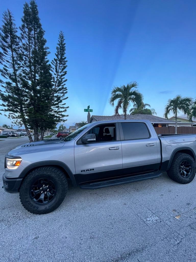

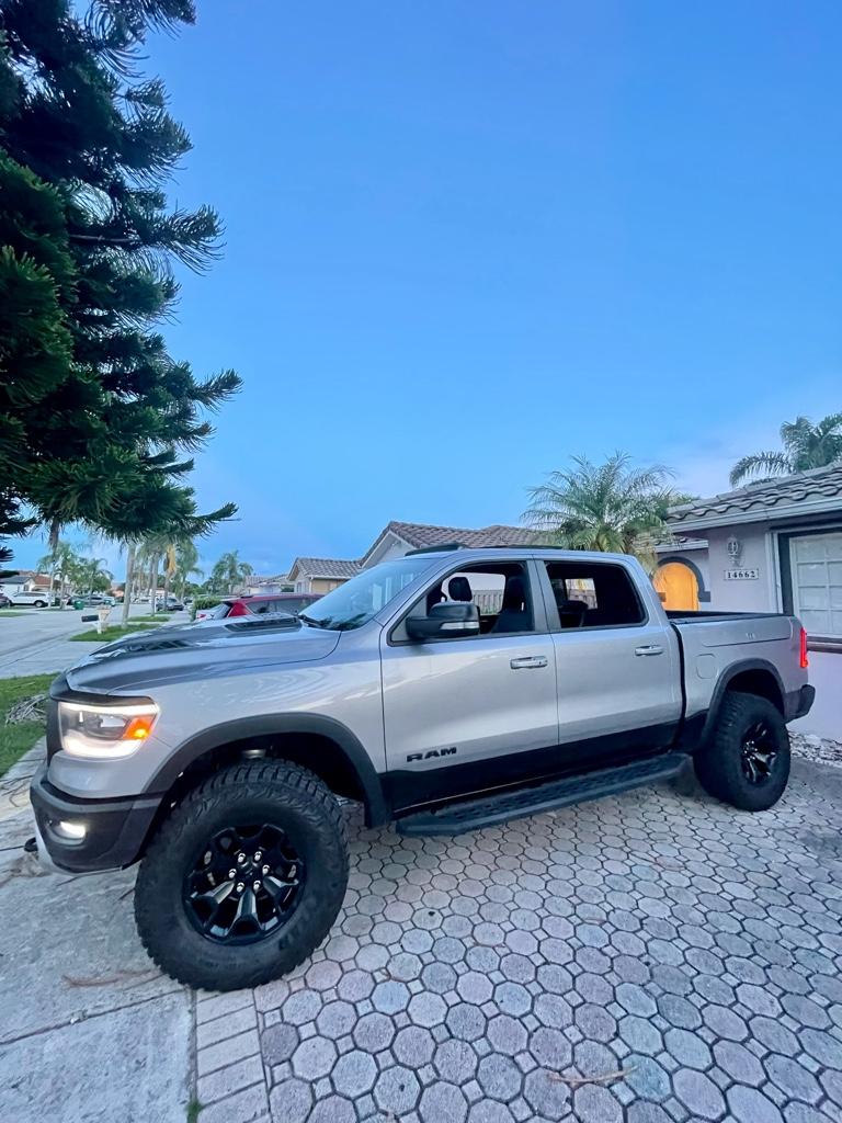

TRX baby brother
Looks great. Quick question, I just installed the TRX wheels on my Rebel with 2" spacers and It rubs when wheel fully turned. Did you have to mod the liners? Thanks!
I’m also leveled. And yes, I removed the little plastic “mud flaps” and trimmed liners. I also massaged with a heat gun and pulled the liners to the rear with zip ties.
I barely rub on one side at full turn and compressed, that can be fixed with caster adjustment but it’s not enough for me to go get it redone.
Perfect thank you sir I’ll try this!

Quick update, took the “mud flaps” off and cut liners up until tires wouldn’t reach them any more and no rub now on regular air settings. Looks fire I say.
Aired up ^
Aired down

TRX OEM tire is GY Wrangler Territory AT 325/65/18
Little bit of plastiDip, some TRX shoes, and a couple aluminum pucks stuffed in the right spots…
And I ended up with this, a baby Rex lol
(massaged some plastic and metal tabs for the liners to not rub)
What size spacers did you use in the front and back?

Is using 2" wheel spacers really required to fit these wheels on Rebel, or it is more for the looks? I'm curious if a small spacer like 3/8" will clear the upper control arm, and such small spacer will not kill bearings long term.
I had them before the wheel swap. No idea if they are needed. I just dig the perfect look.
as for wheel bearings…. If they die, they die. I’ll buy more. But I’m willing to bet they last a solid 50,000+ more miles
Thanks man! I've ended up with installing 1.5" spacers and modifying the front wheel wells. No rubbing at all, there is plenty of space there.
