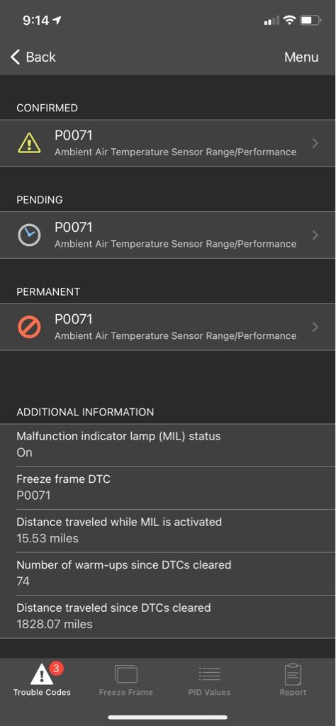

Mine was off by 40F yesterday, which was enough to finally flag a CEL.
I’m not sure how the system knew there was a sensor issue, however... as it’s been off by around 25F for nearly a year. Maybe it finally figured out I’m using seat heat and window defrost too much when it’s “70F” out?
