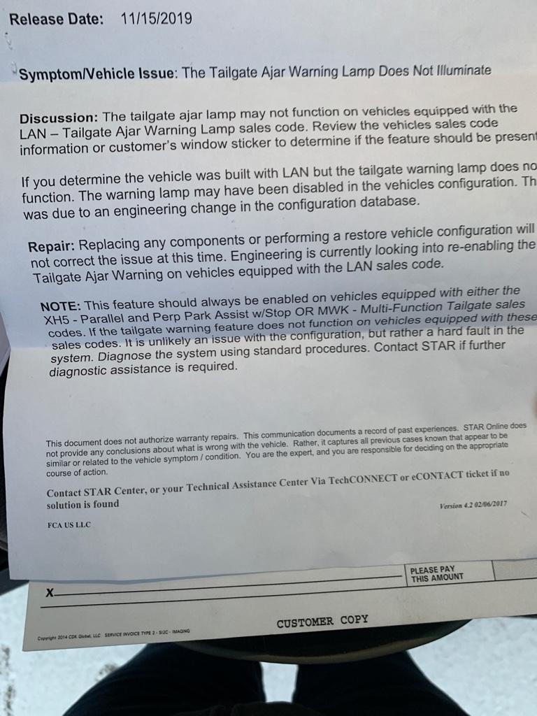

Just got an update. My truck will also require an engineer from FCA to come out and reprogram the truck. I did get some info from my dealer though. I was told that FCA has purposely disabled the tailgate ajar warning (as well as the cargo lights) on any new truck that does not have the 360 degree camera. This is due to the slew of issues (also seen on this forum) relating to the tailgate constantly saying it is open when you go over bumps. So now, the catch 22 is, do I re-enable the tailgate feature and risk having random warnings saying its open. They also suspect a recall will be coming down the pike for fixing the tailgate open issue. At that time, they will have to reprogram all of the new trucks to also have the cargo lights re-enabled. I find it fascinating that FCA had the dealer spend a week diagnosing and issue that they knowingly disabled. What a waste of time for all parties involved.

thank you for the update.. if you get your service ticket that validates this please share so i can take to my dealer. I have bed lights and i want them activated when i open the tailgate

This is what I got at the dealer today, they wont look at it again until an 'official' fix is out. Consider yourself lucky I guess if your dealer will try to fix it

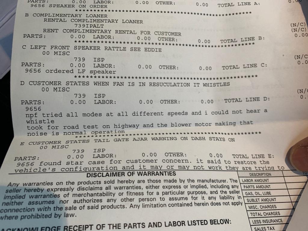

Curious if anyone has had this fixed or looked at lately, my dealer says they checked and there is no updates on it.

My truck is currently at the dealer getting a speaker replaced and some fan wind noise issue, and I asked about it. They looked into it and they said FCA is currently looking into a fix. So hopefully within the next decade they have a fix for it

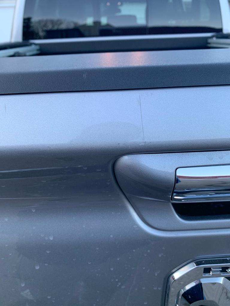

My exact thoughts lol the tailgate opened and I drove away, 100% my fault because I pressed the tailgate release button instead of remote start button, and the truck was backed up against a wall so it scratched it. But, I wouldn’t have driven away knowing it was open. And it would be nice for the lights to come on automatically while it opens lol but I picked the truck up from the dealer and they said that FCA is working on a fix and that they know about it
