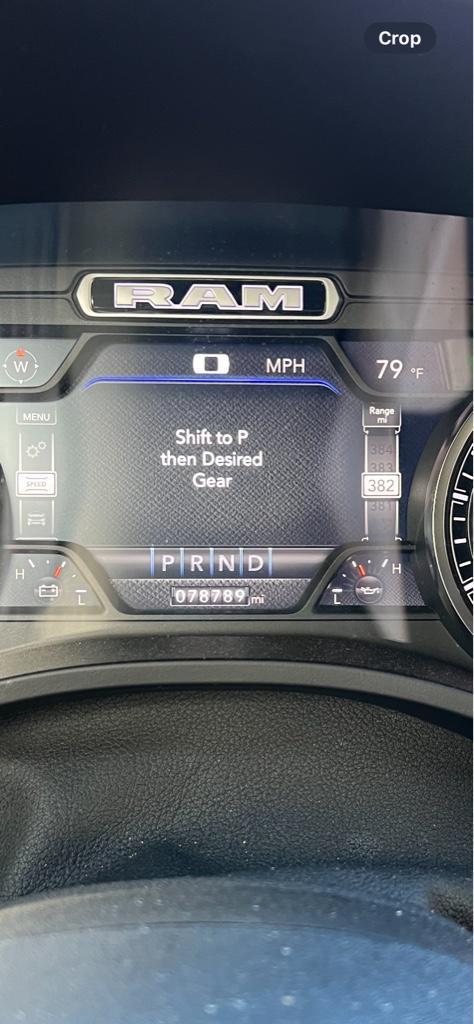

Transmission randomly shifts into neutral and shows error to shift into Park then back to Drive

I’ve been having issues with my transmission going into neutral when I drive, usually happens at lowers speed when slowing down and in the first 5-10 minutes after start. It shows error to shift into park then back in drive. I went to dealership and they said they updated system and I shouldn’t have problems but still same issue again. I went again and they can’t find any error codes in the system. I bought 7yr unlimited miles warranty but not sure how to push to get something done about it. Anybody else have or had this issue?

Yes, I cleaned throttle body and exercised flapper by hand through over travel to smooth out position sense, get rid of sticky or erratic motion, cleaned air flow sensor. It seems counterintuitive but my theory is tps has some oxidation and is sticky and mock stalls timed with downshift, software responds and forces park and back to drive sequence. Far fetched but should clean this anyway (it was dirty)and some how beat my mean time between failure from 1-2 times per week, it has been months without recurrence now. Hope this helps.
