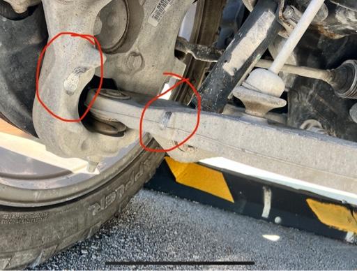

3. Cranking Noise when turning wheels and scratching of lower arm and steering knuckle

One thing they still did not fix is lower arm scratching on wheel knuckle, dealer stated “it’s normal”, is that even ok to say that? 2 parts of car scratch on each other and they say it’s normal.
That is normal.

That is normal.
How is that normal? Can I get your input on this [mention]RamCares [/mention], is that normal that lower arm is getting in contact with knuckle? See picture I posted above
